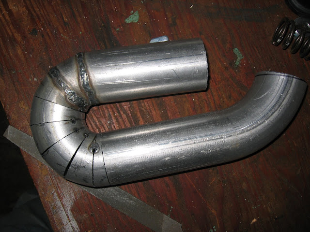

jakeru's Avatar
Joined: Oct 2002
Posts: 87
I'm in the process of making the tight radius bend for an equal length y-pipe (which will mostly be a copy of 505max's design.)
I would have welded this up, but I ran out of Argon gas in the middle (I'm using TIG welding.)
This started as a mandrel "U" bend with a 3.0" centerline radius. You can see some of that radius to the right. With several sections removed, I am tightening the bend radius up to about a ~1.5" centerline radius. This will help it fit nicely under the car.

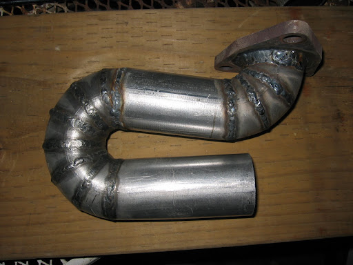

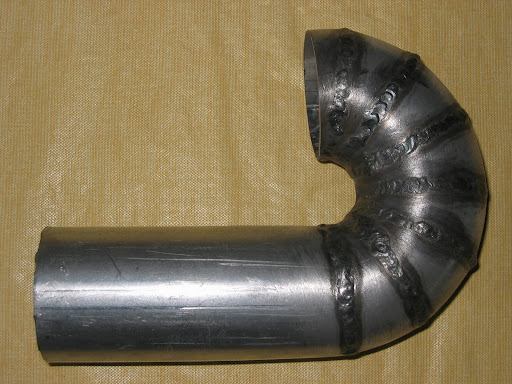

  #262
jakeru's Avatar
Joined: Oct 2002
Posts: 87
505max - got any pics of your newest ELYP design (you mentioned you had shortened it since the initial design?)
I finished welding up the tight bend:
It was some good TIG welding practice for me.
wouldn't a bend that tight hurt the flow a bit?
looks kinda messy for TIG...but still good.

jakeru's Avatar
Joined: Oct 2002
Posts: 87
I'll bet it impedes flow a lot less than the factory equal length Y-pipe. (Have you seen how tight the bend is inside it?)
And thanks for your honesty about my TIG welds.

DanNY's Avatar
Ad·min·is·tra·tor
iTrader: (14)
Joined: Aug 2000
Posts: 17,724
good point...but would a different design be better?
if it's functional then it's good enough for me. beats the bubble gum welding that i've seen others do.
The bend is just as tight as mine, but his is better. If the bend increases in radius, you'll lose ground clearance... Of course, any bend hurts flow, but do you think that the oem bend is better?

OK... another progress update on my WSP Y-pipe equal length modification project!
I am fully committed to what I call "phase 1" - modifying the rear bank's secondary pipe to make it longer (I already removed from my car, and hacked up the WSP Y-pipe, including amounting flange which is pictured above). This will make the Y-pipe much closer to equal length, but not completely there.
Phase 2 will be modifying the front bank pipe to be shorter, to make it truly equal length. (I determined with a different path, with the pipe cutting closer to the front of the oil pan, it's length could be reduced by up to about 4".) I'm not sure if I'll do both phases at once, or try it out in between... depends, we'll see.)
Are you sure that it won't hit the oil pan on your VG? I'm almost positive that your design wouldn't clear the VE's oil pan.
FYI, my design barely touches the oil pan...
