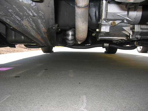

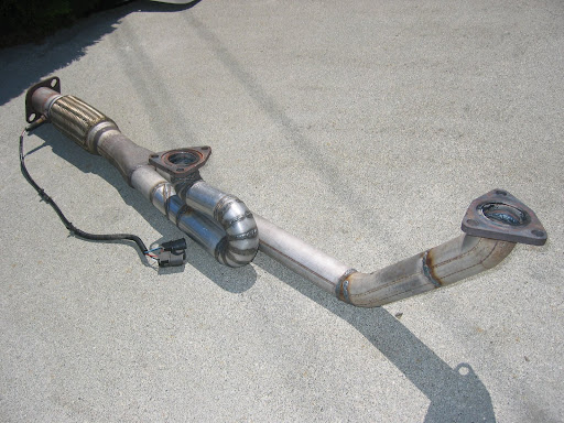

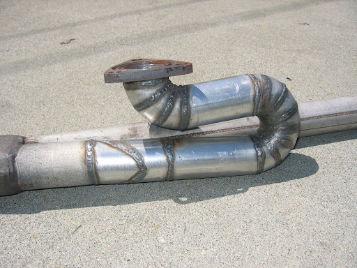

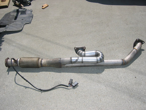

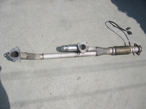

My equal length Y-pipe is done!
I've got about a finger's clearance between the oil pan and the rear pipe:
I got the secondary pipes lengths about 2" away from being totally equal. (Previously they were different in length by about 22" from cylinder head to "Y" -- so I removed 90% of the length difference.) As you can see from my design, I did this by both lengthening the rear pipe as well as shortening the front pipe.
Result: in terms of quieting the exhaust (the main reason I did this) the results were mixed, althoughgenerally positive. The exhaust tone is markedly different now and does sound much better. I would describe it as more mellow and refined sounding. Sounds more like a performance tuned BMW inline six. Before, it just used to sound like a car that needed a muffler (and for the record the rest of the exhaust is a full WSP 2.5" mandrel bent, with resonator and a stock cat, and I've tried three different mufflers on it.) The tone "mellowed out" a bit, which is good, but it still is pretty loud in some cases.
In terms of change in power and torque, I don't think it made much affect in the low RPMS, but I was real surprised how it seems to now just keep pulling harder and harder as the RPMs rise, especially in the 3500-redline (5500 RPM) range. I would say the butt-dyno is registering a definite increase in power here folks.

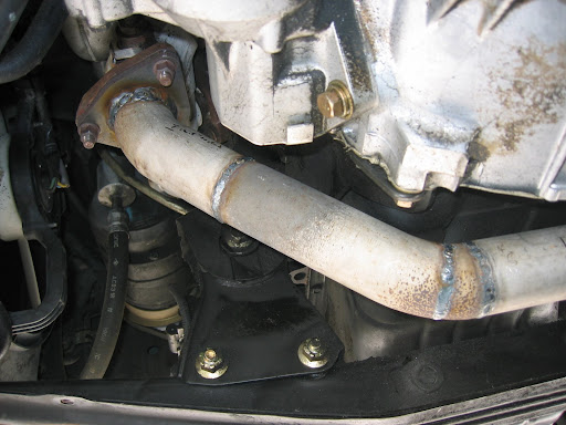

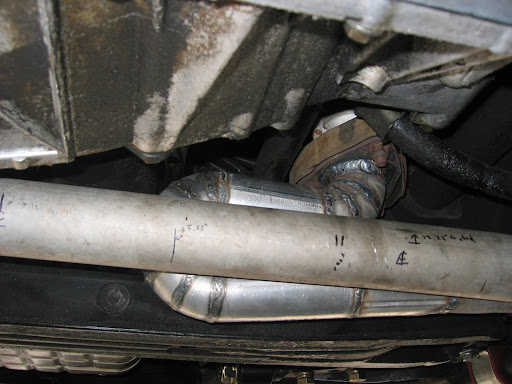

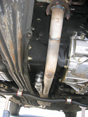

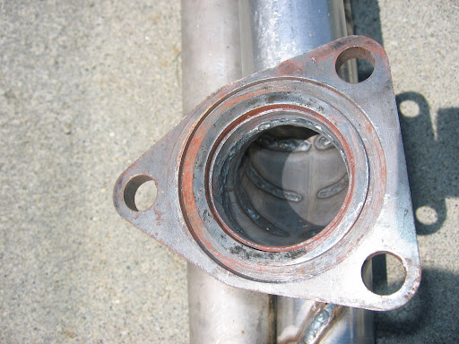

Here are some other pictures of it:
Ground clearance shot: (ELYP is about as low as engine support; Swaybar is lowest)
Modified front pipe (it's close to the oil pan now)
interior detail
top view
Old Jun 4, 2009 | 09:56 AM

With my Y-pipe modification, I raised the position of the pipe over the swaybar by about 1/4", to add space between Y-pipe and swaybar necessary to remove some cheesy swaybar spacers I had in there previously to keep the (WSP) Y-pipe from banging on the (Suspension Techniques) swaybar under hard acceleration.
However, this change did throw off the alignment of the rest of the exhaust system, which I think I should fix before recording vids of the sound. (Right now the resonator or is pressed up against a heatshield under the car, and is probably transmitting engine vibrations to the chassis.)
