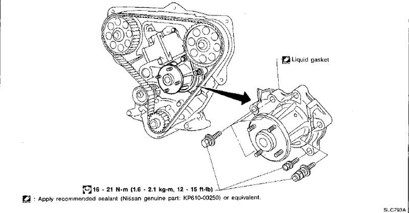

Well looks like the thermostat. I tried to find a write up for installing the thermostat. Could anyone show me a write up with some pics? Or got a scan of the Haynes or FSM?

ill tell you what assuming that this IS a vg we are talking about just look right above the pulleys on the passanger side of your motor. you will see where water hoses all come into 1 central location( that is your thermostat housing, drain your fluid un hook the hoses from housing unbolt lid to housing and walla theres a little thermostat sittin inside.
Old Jul 5, 2010 | 04:08 PM

Yes its a VG. I read other stuff that made it seem complicated. I don't have to touch any pulleys or any belts?

Not there....
Here...

Here's where the thermostat fits.....
See the blue tape!!!!
Inside this housing!
