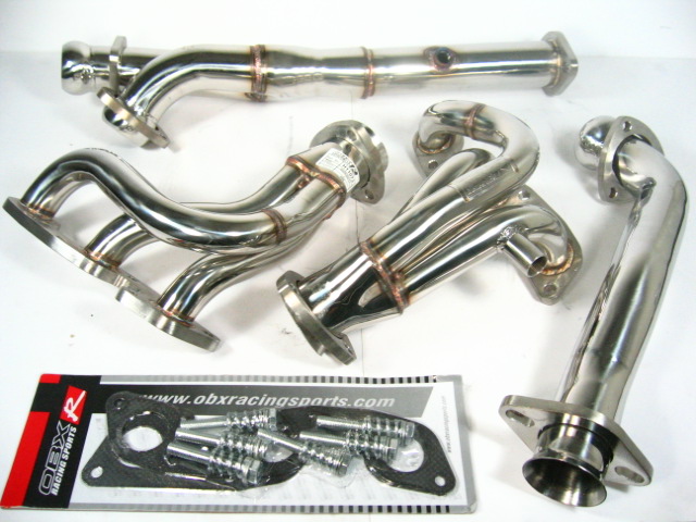

Je piston obx headers

Wow! Nice! Now what's the deal with the headers? What does customized inc headers mean? Or was that a typo?

Typo the header manifold was bored to match ports its only about 1/4-1/2 " on either side that had to be ground out but kind of cone shape it in to smooth flow and as for bolting up the same forget about it you gotta find your centers which match up vg and Ve lucked out ports centers are same apart but just center the height and side to side then mark and modify holes for exhaust studs as for head work they been cleaned new springs that's about it I get spare heads complete maybe someday ill tinker with them but I'm not going for speed anymore no point just to finish a 8 yr project

Those headers are these same ones.....supposibly for a VG huh?

Originally Posted by 3rdmaxse0
Typo. The header manifold was bored to match ports; it's only about 1/4-1/2 " on either side that had to be ground out, but kind of cone shape it in to smooth flow. As for bolting up, the same; forget about it you gotta find your centers which match up. VG and VE lucked out; ports centers are same [distance] apart but just center the height and side to side, then mark and modify holes for exhaust studs. As for head work, they've been cleaned; new springs; that's about it. [If] I get spare heads complete, maybe someday I'll tinker with them but I'm not going for speed anymore; no point, just to finish a 8 yr project
For anyone who was having as hard of a time reading that as I was. (Not trying to be a jerk, it was just really hard to read without any punctuation.)

Wow! That was much easier to read. As for the headers, they are indeed for the vg. I found a great deal on eBay and was actually planning on cutting and swapping flanges.
Yes! What is up with that. I thought no one made headers for the VE. If they did I would've bought them.
Those are OBX VG headers with round exhaust ports not oval...... but check this out they might work on a VE.....
http://forums.maxima.org/5th-generat...r-headers.html
