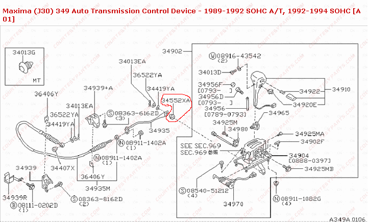

shifter bushing would be the first thing to check. odds are it's either partially or completely missing.
the park/neutral & PRND2L sensor is on the tranny-side of the shifter cable (away from the hot exhaust), so when the rearward (right above the hot exhaust) bushing is worn, your shifter can move without the cable actually moving, making the sensor incorrectly read what position you want to be in. It takes 5 minutes to install and is $3 at the dealership.
jack up side of car, undo the 2 10mm bolts that hold the cat converter heat shield, and see if the cable has alot of play against the peg
in my case, my bushing was totally missing, so this is what it looks like in that situation (video)
to buy online (tho shipping is high for such a cheap part. better to buy at local dealer) http://www.courtesyparts.com/34552xa...4-p-48245.html
see 34552xa

there's a safety switch on the tranny that prevents you from starting the car unless you are in P or N. If you put it in R, D, 2, or L, it won't start (assuming the bushing isn't broken/missing). But the sensor is on the trans, and is moved by the cable, rather than being on the shifter itself, so if the bushing is allowing for freeplay in the cable, then the shifter might be saying one thing while the sensor can be reading another. The exact same thing has happened to probably a hundred members in the 3rd gen section at one point or another... it's a common problem, and a cheap, correct, long-term fix.
as for how to check it, i already told you. a couple posts ago.. but to say it again...
jack car up
undo the 2 10mm bolts on the driver side of the cat conv heat shield
pull shield down with your hand
inspect the presence or absence of a plastic/nylon bushing between the cable and peg, that looks like this:

Thanks for the info. I guess it really is the bushing because it happened again earlier today and shift from P to 2 to P again then it started.
Anyways, I once did turn off the car, parking brakes engaged, and gear on D then started the car successfully.
I'm also not sure if this has any correlation with the problem. When I back up my car and shift to D, sometimes it won't catch the gear and will only revv until shifting to N to D again will engage the D gear.

Yup, 99.99999% it's gonna be the bushing. Since there's free play, when you shift do D, the transmission will still be in the N position which explains you "starting it in D" and no gear on D.

yeah, that's more symptoms of the same problem (bushing) .. the shifter moves 3 positions (P to D) but the cable only moves 2 due to the freeplay, so the shifter says D but you're really in N.
[IMG]http://i164.photobucket.com/albums/u16/capedcadaver/th_MVI_2278.jpg[/IMfG]
see 34552xa
[IMG]https://i.imgur.com/I2Vr0.png[/IMfG]
if it were the starter, then why would moving the shifter around suddenly cause it to start like a champ? especially when one is $3 and takes 5 minutes to install, and the other is $100+ and takes a while (tho still not all THAT long) to install...

as you'd have seen if you'd have clicked this link, this is a regular Nissan dealership who also sells stuff online, and they are only charging $2.24... same as what they'd charge a walk-up customer. Your local Nissan dealership probably doesn't cost much more than that.
[IfMG]http://i164.photobucket.com/albums/u16/capedcadaver/th_MVI_2278.jpg[/IMG]
see 34552xa
