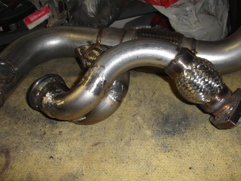

here's my set up...unfortunately i changed it 3 times after this pic...but you get the idea.
fabrication...
part of a 3" DP V-band clamp
so yeah...before you come out and ask total random questions you need to give us some info on what you have now instead of rambling out a list of parts that's available off the shelf. i'm talking about the technical details.
