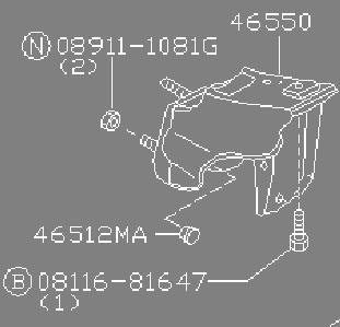

is there something there that i can mount the top bolt to or will i have to go without the top bolt?
also is there a spacer that goes on the firewall. does it go flushed to the firewall sheet metal? is there a spacer? the mounting studs seems to be super long...long enough to have something in between.

ok found the top bolt...but it's a good distance from the firewall...now what?

there is a spacer that goes in between the pedal assembly and firewall and when i done my 5spd swap i had to drill the hole in the firewall also.

is it a part that i need to buy or is it part of the f-wall on manual cars that auto cars need to fab up or something?

No "spacer", but the soundproofing material between the mount and firewall is supposed to be there. It's a good half inch worth of foam and that hard black moulding. Might want to hit up the junkyard and cut out that area of soundproofing from a stock 5 speed and graft it in there.

it does have the soundproofing but there is a spacer that is spot welded to the fire wall once the pedal assembly is out of the way you can bend it back and forth to break the spot weld. if you need one i think there is a 5spd car at my local pullapart just let me know.

just for reference i'm referring to the spacer between the pedal and the firewall (the two studs from the pedal bracket) not the top bolt.
the sound proofing crumbles in my hand so i'm not sure how well that's going to hold up.
