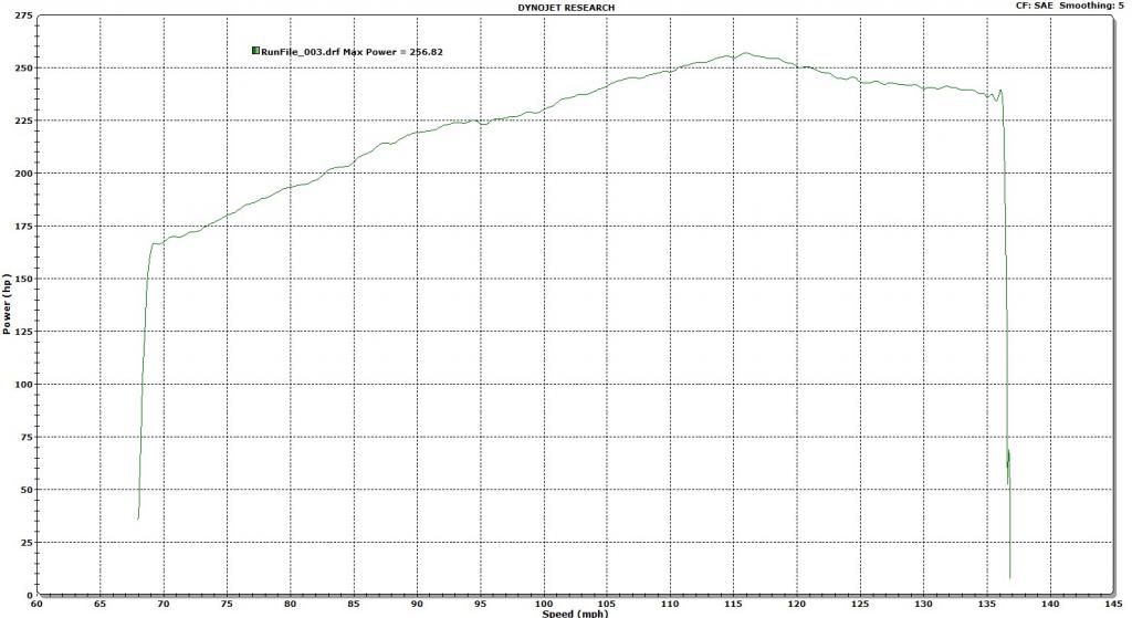

get a dyno, tells you what HP you're putting down at what speed.
http://i4.photobucket.com/albums/y12...ps8493e182.jpg
