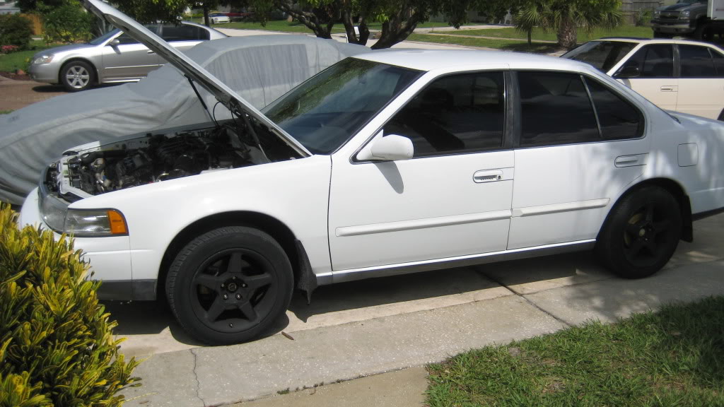

Hey guys, I'm new to forums but love working on cars. Just bought 2 sweet maximas off of craigslist about a month and a half ago and finally started working on them a couple weeks ago. Here's what I got.
1992 gxe auto with ve5 swap (sort of) for $400
This is going to be the one I build.

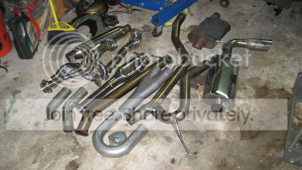

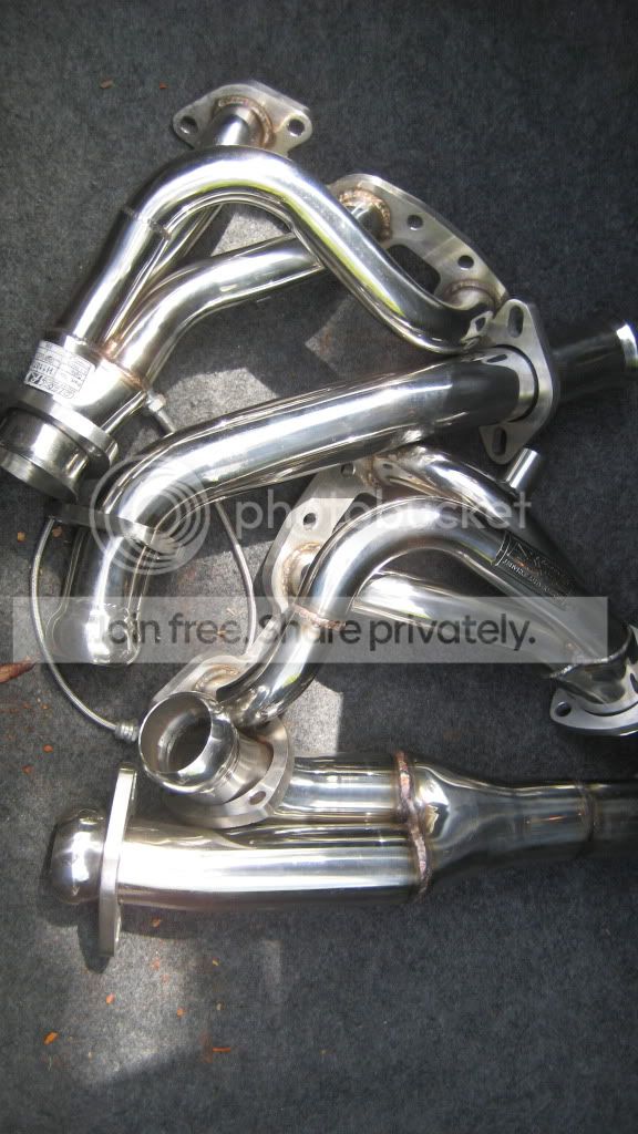

The SE has 160000 on the motor and body, and the GXE has 240000 on the body and 160000 on the motor.
Cant wait to get this project underway. I'm hoping to have some time In the beginning of August to pull the motor on the GXE and fix the exhaust studs/build some sort of a header/y-pipe deal.
I bought some ching chong china chrome VG headers to modify and managed to scrounge a few other exhaust parts from my garage for this exhaust project.

Ah you got the OBX setup. Other wise known as the Pacesetter headers. Hey at the joint where the 2 pipes converge into one on the y-pipe make sure there isn't a gap there. (manufacturing flaw) Just have a muffler shop weld that lil gap shut & then install. Otherwise you will be searching for an exhaust leak.
