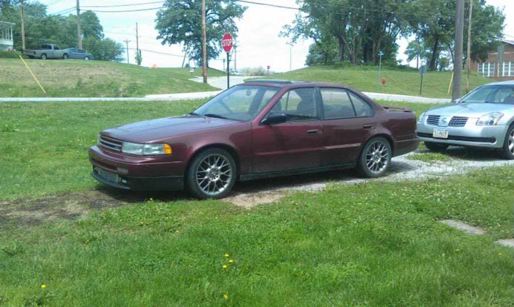

Can you post a pic of you drop? I'm thinking about buying b&g springs.
Old May 27, 2013 | 03:31 PM
TonyJr's Avatar
Joined: Sep 2011
Posts: 1,048
Nice drop. Do you have a ve or vg?

3-bar grille = 89-91 = VG for both GXE and SE. Also note he has an intercooler
