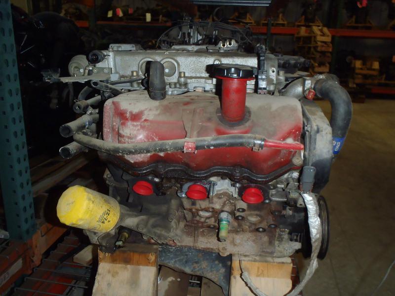

For reference, oil pan at the bottom.
Attached Thumbnails please help me my car is leaking lots of oil!!-t2ec16j-yse9sy0hb-ybrbynb7gtw-60_57.jpg
