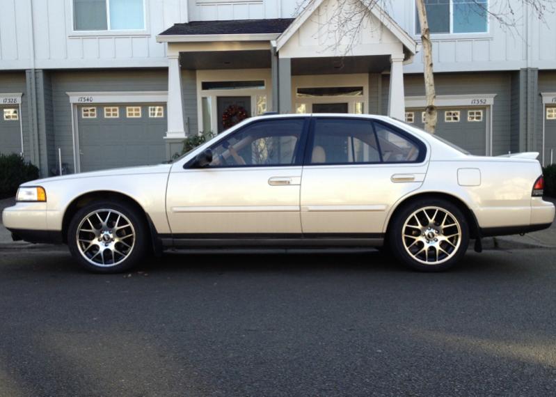

Well here's the picture of the maxima with these on. He told me they aren't maxed out Name:  Screenshot_2014-02-10-02-53-06.png
An updated picture of the coilover sleeves. What do you guys think?Name:  Screenshot_2014-02-19-23-23-44.png

That picture of the 3rd gen doesn't prove or show anything. Ask him for pictures of the suspension of that car which shows the "coilovers" installed.
Either way, those sleeves in your picture are again absolutely just universal sleeves. The fact that they're blue makes me think they're the older APC type. I have a box of universal APC sleeves that look identical. They've been sitting around now in my garage for maybe 8-9 years.
I assure you that you can buy the $40-50 ones on eBay and they will be identical to what this guy is trying to sell you for triple the price.

I'm really interested in getting the Ksport gt springs with my 91 but I'm wondering it it will be too low. I'm not worried about scraping, but I'm worried about wheel rub. What do you guys think?
Old Mar 6, 2014 | 01:15 PM
chrome91's Avatar
Posts: 7,621
From: Edmonton, Alberta
depends what wheels youre running, on stock GXE 15s with 205/65/15s and Ksport GT my front tires were tucked a quarter inch into the fender and the rears were about flush to the fender. that was on a few year old KYB struts so i was probably a bit lower than i should have been, had no rubbing issues. just scraping
just before the car blew up i had Rays TE-37 with 235/45/17s and with a test fit it looked like it could possibly rub, never ran them because the rears needed spacers and the car blewup beforehand
