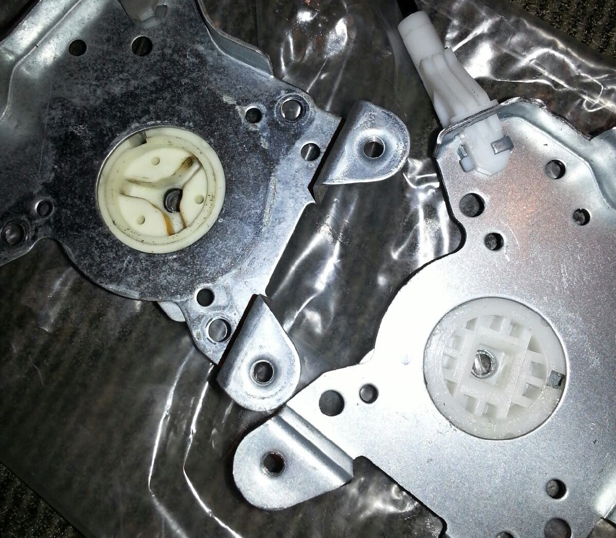

I ordered a window regulator on eBay from this company: carpartswholesale - Click Here for Details
Over the years, I thought I'd learned to avoid a seller with any bad feedback, yet I failed to follow my own rule, and I've paid the price.
I arrived home after dropping the rental car, it started raining. We're leaving tomorrow at 6:00AM to take my son to college 6 hours away. He is taking the car, I wanted the window fixed at least.
Hot, humid, we started on the project because he had to leave to spend time with his friends tonight, before leaving, I understand that.
He also mentioned the car is due for an oil change, oh, we have no oil, no filter, and now we're in a extra bit of a hurry -
We get the old regulator removed, I go to swap motors and found this -
I'm sorry I did not get back with any of you, it's been a hell of a week, and this is not how I wanted it to end, but it did.
I appreciate your efforts, not sure I'm ready to make any decisions on anything right now. My head is splitting from the week, thank you all for everything, sincerely, I appreciate it.

I had the same issue with the drivers front regulator as you did. I ordered a front left and rear right from the same company and got the square mount on the front. Needing my window fixed I used a dremel and made it work. Funny that they are still selling them as I brought it up and sent them pictures of everything. They gave me a $5 or $10 refund (can't remember) for my troubles. This guy looks to have gotten a similar one as well. https://maxima.org/forums/3rd-genera...car-these.html
I guess its true, you get what you pay for.
