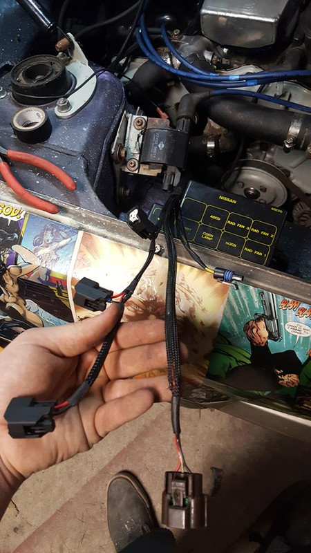

FANS ARE WORKING.
there were 2 things keeping the fans from working. the first problem was the relay i had wired up to be switched by the MS1 wasnt turning the fans on, idk how i ever got the fans to turn on using that relay but whatever it was it was incorrect so i just switched the connector from that relay to the correct relay to have the fans turn on. the fans in the stanza are 2 speed, high and low, to accomplish this the car has 2 relays (three fan relays total but idk what the 3rd one is for, maybe ac or like some sort of safety relay idk) but if you turn on either one of the first two relays its on low and then both relays on at once gives you high speed. since i only have one output to switch the fans on i can only have the fans come on at low or high speed, for now they are on low because idk if high speed will be necessary yet.
the second reason the fans werent working is way more embarrassing and stupid but im gonna tell everyone anyway because it might prevent someone else from making a similar mistake, or maybe someone will find it funny.... the MS1 has 4 spare pins that you can use as outputs to control various things like boost control, nos injection, meth, launch control, 2 step etc. or in my case fan control. what i was not aware of is that in order to use these outputs you have to actually modify the hardware inside of the MS1. without doing this modification the wire i had run to my spare pin was connected to absolutely nothing. so ive been trying to figure out why im not getting signal from a wire that may as well be laying on the floor lol armed with the new knowledge of what i had to do to complete the mod i banged it out, it was actually really easy.
idk if anyone will really understand what this means but i figure its neat to look at. basically signal comes from an output pin and the transistor opens a gate i think maybe which completes a circuit between a ground and the output which closes the relay, im assuming the diode is for protection but im just learning so im not super sure about any of this lol anyway it works. i got the car warmed up a bit, had the fans kick on and off at certain times. they kick on slightly earlier than what they are set at which i found strange, i guess they account for temp spiking or heat soak or whatever in the code instead of trusting you to use the right temps which is nice. i have no idea what operating temperature is supposed to be, once i find that out ill set the fans at that and probably take the car for an extra long spin and start getting it better street tuned and fix the warmup enrichment and be well on my way to tire roasting. just from dialing the fuel in when it was around 160 degrees the car runs a million times better and its still running on that year old gas so once i get some decent gas in and get her nice and hot it should get wild quick. i really gotta build some turbo headers tho cause this car sounds like a dying buffalo in the revs.

Nissan uses 3 relays for the cooling fans on the Maxima. Fan Relay 1 turns both fans on at low speed. Fan Relay 2 turns fan #1 on at high speed and Fan Relay 3 turns fan #2 on at high speed. The reason for using a separate relay for each motor's high speed is unknown to me. This design would allow each fan motor to be operated at high speed independently from the other one, but the fans are connected to always operate as a pair. There is one pin on the ECU that says run the fans at low speed and one pin that says run the fans at high speed.
I will assume that the Stanza is set up the same way since it also uses 3 relays. If the car has air conditioning, it is necessary to have the cooling fans running when the a/c compressor is running.

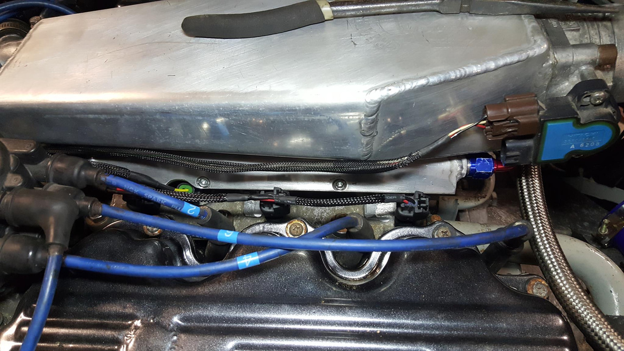

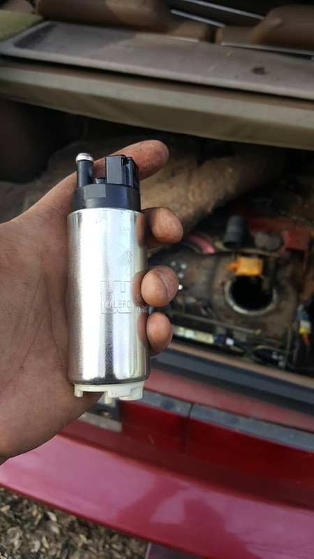

decided to redo the fuel rails again and install my bosch 550s i originally got for my Z31 in the stanza. i feel like the stanza has been down a cylinder because the one injector wasnt working. i know the 550s are good and i wasnt really happy with the way the injectors were done so im gonna change it lol i just got the stock today so new pics on that and hopefully burnout vids once the car is running right.

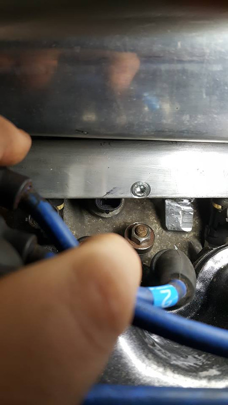

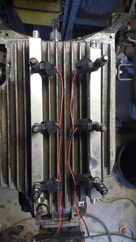

ok so the drill bit made its way to home depot today so i went and grabbed it and rushed home to see if it was actually the right size and if it was going to drill round holes or just turn my rail stock into scrap. being an idiot with a half decent memory i recalled the mistakes i made the last time i made a set of fuel rails and practiced/setup my jigs and stuff on a section of -8 fuel rail i had lying around that im not using for anything atm. (the rail stock im using for the stanzima is -6)
first i scribe the center of the rail, then i locate the exact position along the length of the rail that i want the injector to go (in this first case on the scrap -8 rail it doesnt matter) then i punch mark at the intersection of each mark which leaves me the spacing i want. i spent a few times marking and checking to make sure when i was done the rails would be exactly parallel because the even tho the injector bosses in the lower are exactly the same distance apart they are offset from one side to the other so some margin is required to make the rails line up. once i had my marks laid out and punched i pilot drilled with a 1/4 inch bit, then stepped up to whatever size it was that the top of the injector was (idr) so that it could pass through the hole but the oring would seat against it and then finally i drilled the oring boss with a 17/32 bit and sanded down all the burrs and sharp edges with some 220 grit sandpaper.
here is the first rail after drilling and sanding
with injectors, notice the offset from one end to the other.
both rails done.
i couldnt really get a good shot of the rails being perfectly parallel lol its hard to tell but they are even.
so next ill be turning and tapping some mounting studs that ill cross drill the rails for and then weld to the lower so the rails will just have 2 bolts going through the side to hold them on. fortunately my old injectors are the same physical size as my new ones so ill just use them to hold the rails in place while im welding so i dont have to worry about arcing into them and destroying the 550s. after the studs are done ill have to get some fittings and bungs and do the fuel lines, i already have most of that stuff once again being donated by the Z so that should all get done very soon.

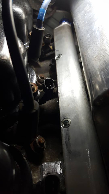

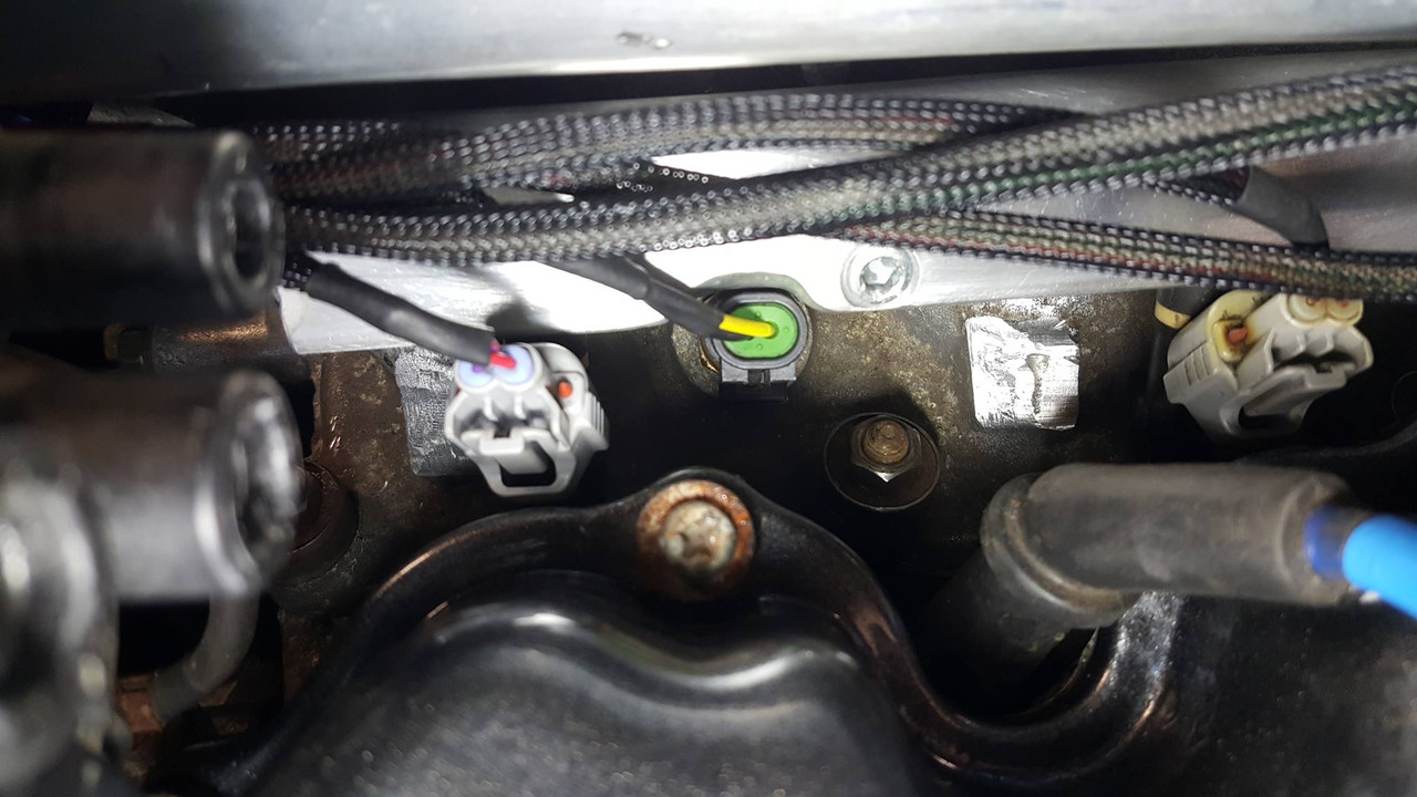

fuel rails are almost completely done. made a lot of progress on them today, basically spent the whole day on them.

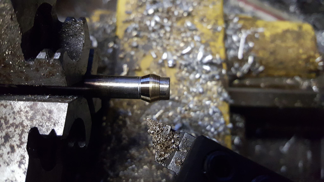

first i cross drilled the holes for the mounting bolts
then i made a pair of threaded studs.
then i cut them down till they were about the right length, rigged up a bunch of random crap i had lying around to get the rails to stay where i wanted them and then tacked the studs, took everything back off and fully welded them up.
these are the same bolts i used on the z, they are temporary.
here is the second rail done up to the same point. i punch marked the front and rear at this point so i didnt mix them up since they are virtually identical.
while i was out getting salt for the impending blizzard were supposedly gonna get destroyed by i picked up some socket capped bolts so i could counter sink them, i dont really like these bolts, they were black for some reason so i hit them on the belt sander to try to make them more presentable... not sure how i feel about it but at least they are flush.

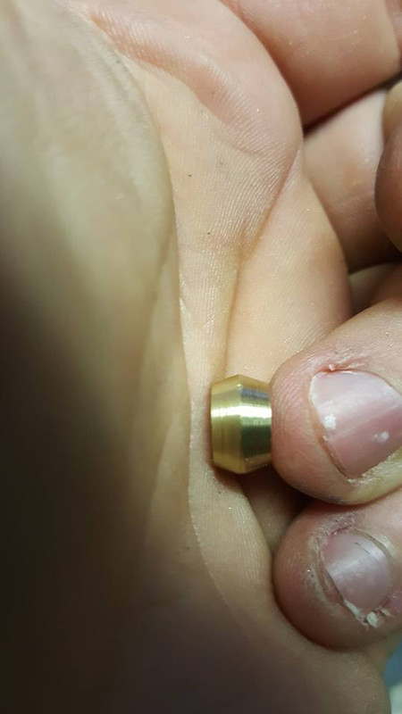

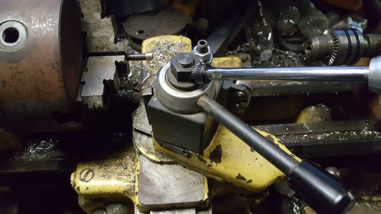

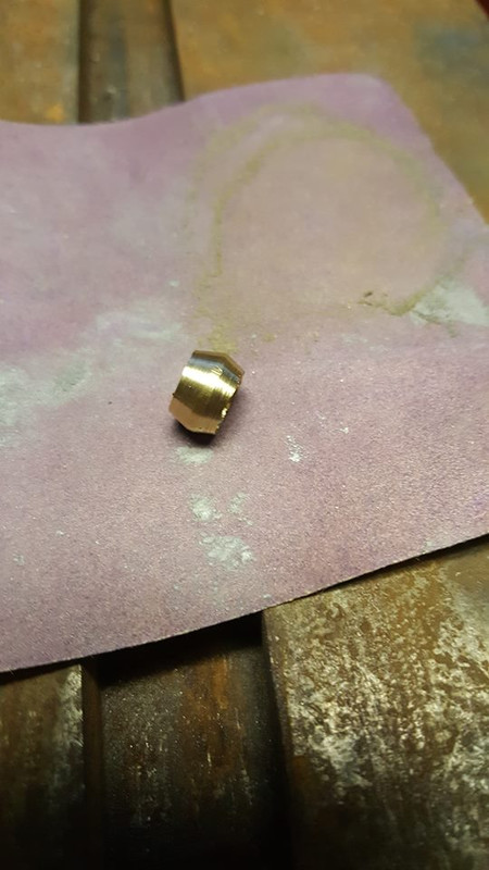

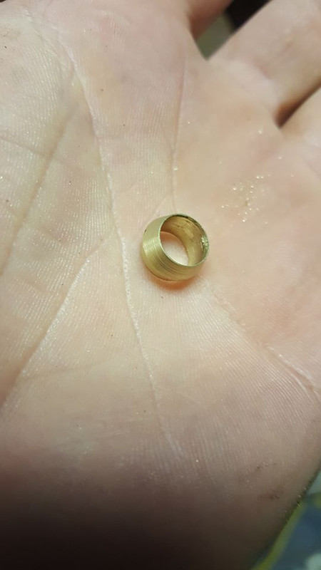

i needed 2 dash 6 bungs for the front of the rails that go to the feed and return but the ones i had were used on something else that got scrapped and got all beat up so i decided to just make myself up some new ones as i have done before.
somehow i managed to get a press fit on the first one without trying or paying attention whatsoever so i did the same thing on the second one for convenience when i go to weld them up.
i might be heading up to the garage tomorrow so ill check my clearances and stuff and see what i feel like when its on the car. i cant fit any other kind of joiner where the loop needs to go in the back of the rails, theres not enough space for braided or hard line fittings and i cant loop them around anything either so it has to be barb fittings and a really short section of hose. im confident i can get it to work well but its been the biggest hangup so far, ive done everything else before when i made the same exact design of fuel rail for my z31.
the fitting is made from 2 different sizes of rod, the larger one i drilled a blind hole about as big as i felt comfortable drilling it and then drilled a hole in the side, turned the barbed fitting side and a press fit and a shoulder on the other side and then tapped them together. this joint would get welded and then the whole fitting would be welded to the end of the fuel rails but this was just a proof of concept/making sure i could actually do it so if i decide to change the design i wont care that becomes scrap lol
next post should be about the final touches on the fuel rails and mounting up the FPR, making new feed and return lines, a new vacuum line and wiring in the bosch 550 injectors and hopefully getting the car to run better than it has in years. we will see.

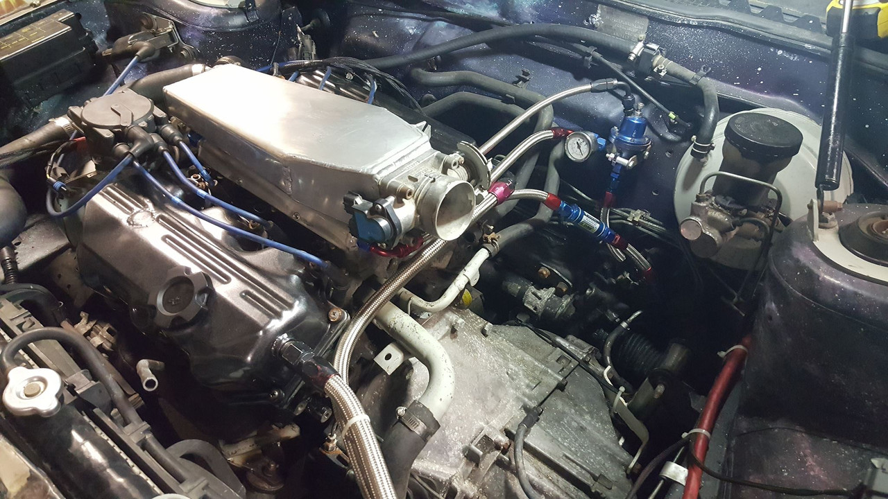

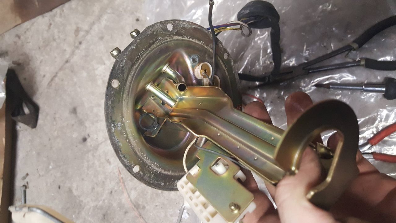

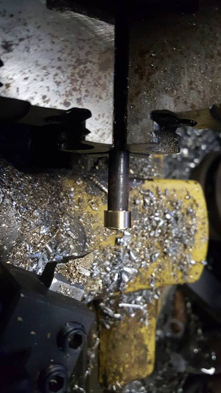

so yesterday i spent pretty much the entire day maching and welding together these little angle pieces, you wouldnt think it would take all day but the thing is i had to make them 4 HECKING times because my welder doesnt have any kind of pulse control and i kept melting the small parts until i machined them as thick as possible lol these were the last iteration and at this point i was about ready to lose my mind.
as with all things sometimes even the most determined and hard fought effort is rewarded in a plentiful bounty of failure, even after successfully welding these fittings together and getting them tacked onto the rails i realized this solution would not be viable whatsoever lol there was no way to actually get the hose between the two barbs once the rails were back on the intake, the one rail actually couldnt even come on and off the intake at all so i just had to break them both off and throw them away. i was too pissed to take pictures but i never really liked this solution in the first place tbh and ive already come up with a more elegant solution so ill be posting that very soon. i would much rather have a bad idea fail and be forced to come up with a better one than have it succeed and have some consequence come later on, the frustration will pay off lol
so that brings us to the day before yesterday or whenever it was that i brought everything up to the garage and mocked it up just to make sure i was on the right track, everything looks like its going to fit fine but i decided i would need an FPR bracket. i know i wont need a bracket for my fuel filter or at least not anything crazy (probably just a P clip)

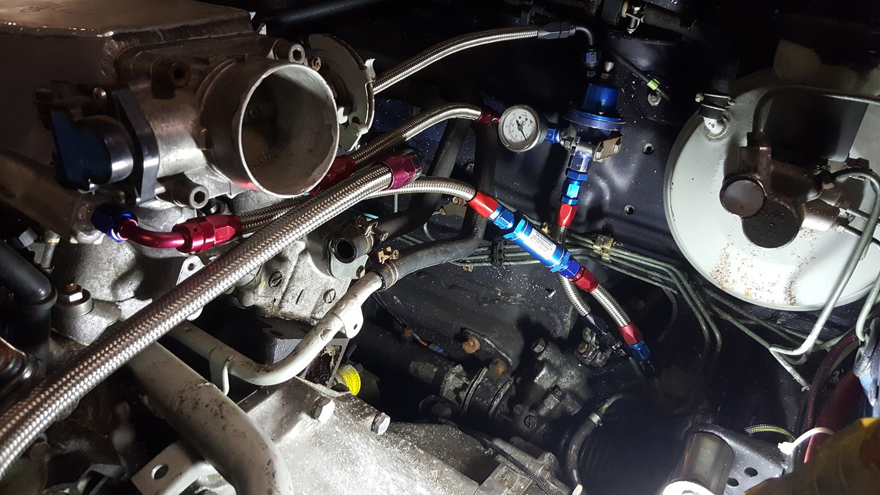

i decided the stock fuel filter was a perfect location for the FPR so i took the bracket for it home with me.
this was the bracket i had made for when this FPR was in my Z. you may notice this is not a regular FPR this one is actually for a kenne bell supercharger i believe, it had like one of those oring bosses you would just push into the side of something and bolt it on, i just drilled that out and welded an AN fitting to it (the heat turned the anodizing purple lol) the bracket looks pretty jank but it held it solid so i decided to keep the basic design and just kind of improve it with new materials.
here is the fuel filter bracket, i really only took it for the bolt pattern, im not going to modify it in any way its going to be scrap.
here is the new bracket, couldnt really be simpler, just a piece of steel with 4 holes in it and a 90 degree bend.
i also took this opportunity to make new spacers, i figured having one solid spacer would make it easier than having 2 little ones and it only took 10 minutes on the lathe to do.
heres the bracket all done and bolted up. obviously ill have to bolt the bracket back onto the car first and then the regulator but i figure once its on there ill never have to take it off again i can just pull the lines for whatever im doing. regardless it should put the regulator where i want it.

FPR bracket is installed and looks good. some of the lines are done but i am still missing the adaptors for the stock hard line. im not gonna replace that until i need to upgrade the fuel pump and stuff which definitely wont be necessary anytime soon.
hopefully this area will look a little less cluttered once the intake and stuff is back together. im not sure how i feel about all this braided line in one place lol but it should all work so thats good enough for me.
didnt really have too much to do after that last night. i just got the fittings for the rear loop on the fuel rails today so ill post that up soon but i do have one more thing to show, last night a friend brought me a little present. since im upgrading my fuel i figured id have a little headroom for more boost so i decided a little upgrade from the hx35 might be in order.... NBD not really anything too crazy just a little S475.

i finally got the fittings i needed and got the fuel rails done. basically all i did was mount the fuel rails up and then i used a square against the rails and the fittings to make sure they were going to clear the rear of the lower intake and thats how i figured out how much to take off of the left rail, then i used a straight edge on the machined mating surface of the coolant neck to take a measurement for how far away the fuel rail was and then transferred that measurement to the other rail to make them exactly the same length in relation to each other since the offset made it impossible to just cut the same amount off of each side (plus they werent perfect to begin with, now they are) for anyone that is curious i cut the rails in my bandsaw with one of those little sled things to try to get 90 degrees and then used my 12 inch disc sander to bring them in and clean up the cut then chamfered the holes with a step drill since i dont have any bigger deburring tools, i also filed the outer edges.
once i had that done i welded on the 6AN bungs.
i did my best to make sure these parts all fit together as square as i could get them so that once i put the fittings on they are perfectly aligned, of course the fittings themselves werent square so that didnt help but there is some degree of leeway for this type of fitting so it still works and holds pressure, i tested them to like 120psi and they didnt leak at all so im pretty happy about that. here are some shots of the clearance, its not crazy tight or anything but it was a difficult problem to solve lol im happy with this solution tho.
you probably cant tell and i really should have taken pictures but i had to grind one of the tips of the fittings down, they have two barbs and i ground a whole one off of one so they wouldnt hit each other. if you look close you can actually see there are only three little bumps in the hose lol
so there you have it, the rails are finally done. now i just have to find or make some new compression sleeves for my adaptor fittings and i can finally finish the fuel system and start the car up. if everything checks out ill be throwing the new 550cc injectors in there, changing the tune and hopefully ruining my perfectly good street tires.

so in order to attach my stock fuel lines to the AN fittings i am using i needed adaptors, fortunately i already had these adaptors from when i did this on my Z and since all the fuel lines in that car are going to be scrapped those fittings were available to the stanzima.........................only one problem. they are compression fittings that use a little brass sleeve to make a seal on the fuel line, they are not a standard part (or at least not something my local home depot carries) and when you tighten the fitting on the sleeve it crimps onto the line which makes an excellent seal but is impossible to get back off and even if you could its going to be too deformed to reuse (which i did try lol) this is one of the original fittings after its been crushed.
so i started with some random piece of brass i had lying around and turned down the outer diameter to what the peak of the fitting needed to be and then drilled a hole through the whole thing to the size of the fuel line, cut off a piece about the length the sleeve needed to be and then i chucked up the drill bit to use it as an arbor to hold the piece.
next i set my compound to the angle i needed and turned the back of the sleeve.
after machining i have the rough part.
then after sanding the burrs off the ends the part is done.
so that wouldnt have taken all that long if i had thought the motor on my lathe exploded and i went through the process of replacing it with a motor i had lying around just to find out that the motor i had wouldnt work and then having to rewire the old motor back in because i realized that there was nothing majorly wrong with it lol that took pretty much the entire time since my last post. but the lathe is better than ever now and i made those fittings yesterday and ran over to install them today, here they are installed! it was a huge pain in the ***.
i already had most of the fuel system setup so once the fittings were on all i really had to do was make the lines that attach them to the other stuff. i basically just switched one line out for another and then cut another to length and swapped out a fitting.
so as you may have noticed i have fuel pressure, i tested the system once it was all installed (i totally didnt install the lines backward and have to switch them exactly like i did on my z btw. (jk i did)) and no leaks! so its all ready to go but before i can start it i have to make a notch in the front fuel rail so i can plug in my coolant temp sensor. that will probably be my next post. one issue i noticed was im not making more than 40psi of fuel pressure even after adjusting the FPR. im not sure if there is another regulator in the tank or what but im gonna look through the FSM, either way this stock pump will most likely be retiring and ill throw a walbro or something in there. maybe even the one that was in my z lol hopefully it still works.
oh yeah and i almost forgot. this is how many tries it took to get the compression fittings made lol most of them were made using completely different techniques and fixtures. this was probably the most difficult thing to make that ive made on my lathe yet. half of them are aluminum because i have more aluminum than brass so i didnt mind sacrificing it to failure.

while i was making these fuel rails i realized the coolant temp sensor was being blocked partially by the rail stock, i hoped i could get the plug in anyway and i almost could but i didnt want to break it or possibly get it stuck and need to take the rails off every time i had to remove the harness so i just took the rail back off and ground down a little clearance for the plug.
it really didnt need much.
now it fits without any problems.
heres the walbro 255. ill be installing this next, then the 550cc injectors.

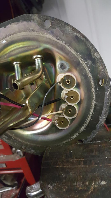

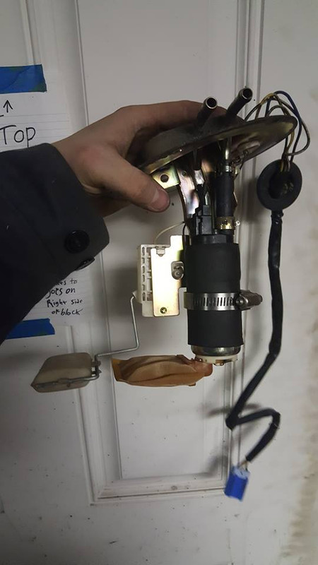

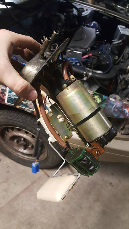

the stock pump comes out.
filter looks pretty beat..
this particular pump assembly has the fuel level sender attached so you only have one plate on the tank to pull. which is nice or at least it would be if i needed to mess with my fuel sender... i dont.
here is the plate without the pump, i had to bend the feed tube straighter and i cut up the bottom part for clearance of the walbro pumps filter.
i drilled a hole in the bracket to run the new pumps wiring through because the routing was going to end up being way longer. i made sure to really clean up the edges of this hole so these wires didnt get rubbed through on it.
i really didnt have to change much, not that i was expecting to, stock location fuel pump upgrades are super easy. probably not a common first mod for people to do but if it made sense for your car or build to do early on id say you could do it relatively unsupervised. one thing you have to be extremely aware of is certain rubbers, plastics and sealants will be broken down by gasoline so i would reuse as much of the stuff that was already in the tank as possible, i would not recommend using any rubber hose that doesnt literally have fuel safe written on it or a serial number that can be traced to fuel safe hose because ive gone to parts stores many times to get fuel safe hose and they almost never give me fuel safe hose (and i never use it)
here are the 550s in the new rails. they were a direct swap because the maxima injectors i was using are exactly the same physical dimensions.

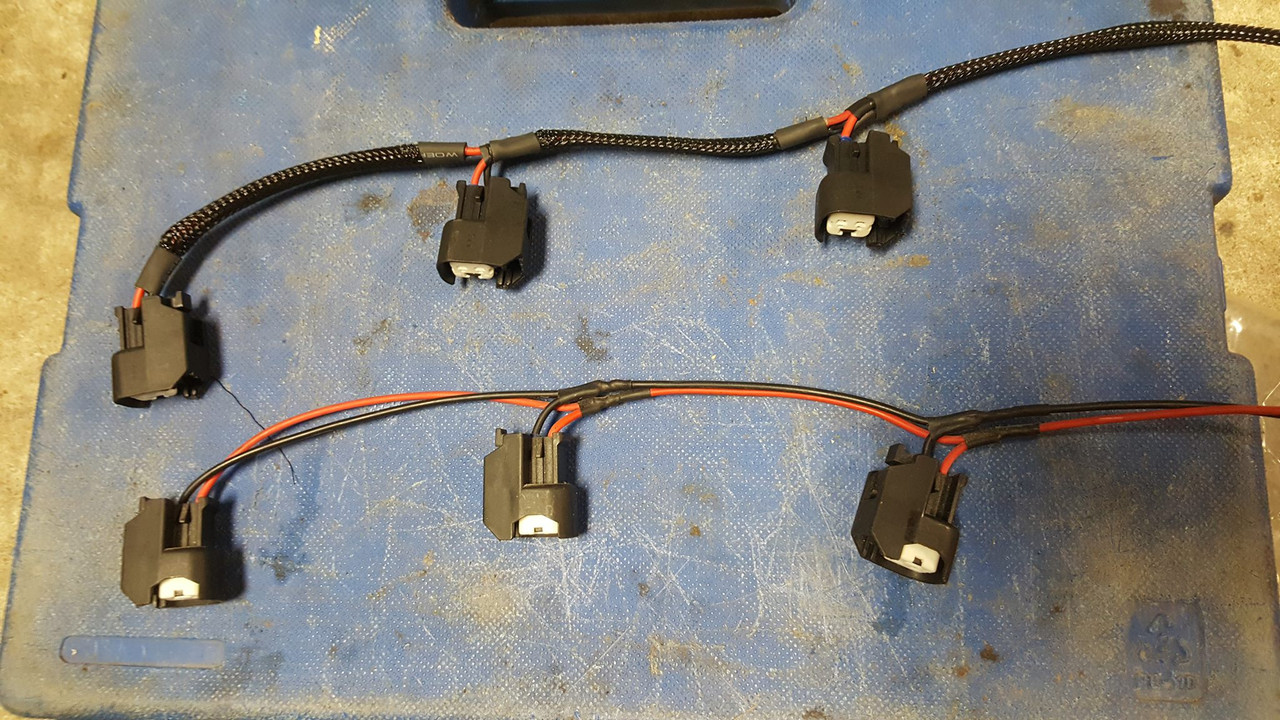

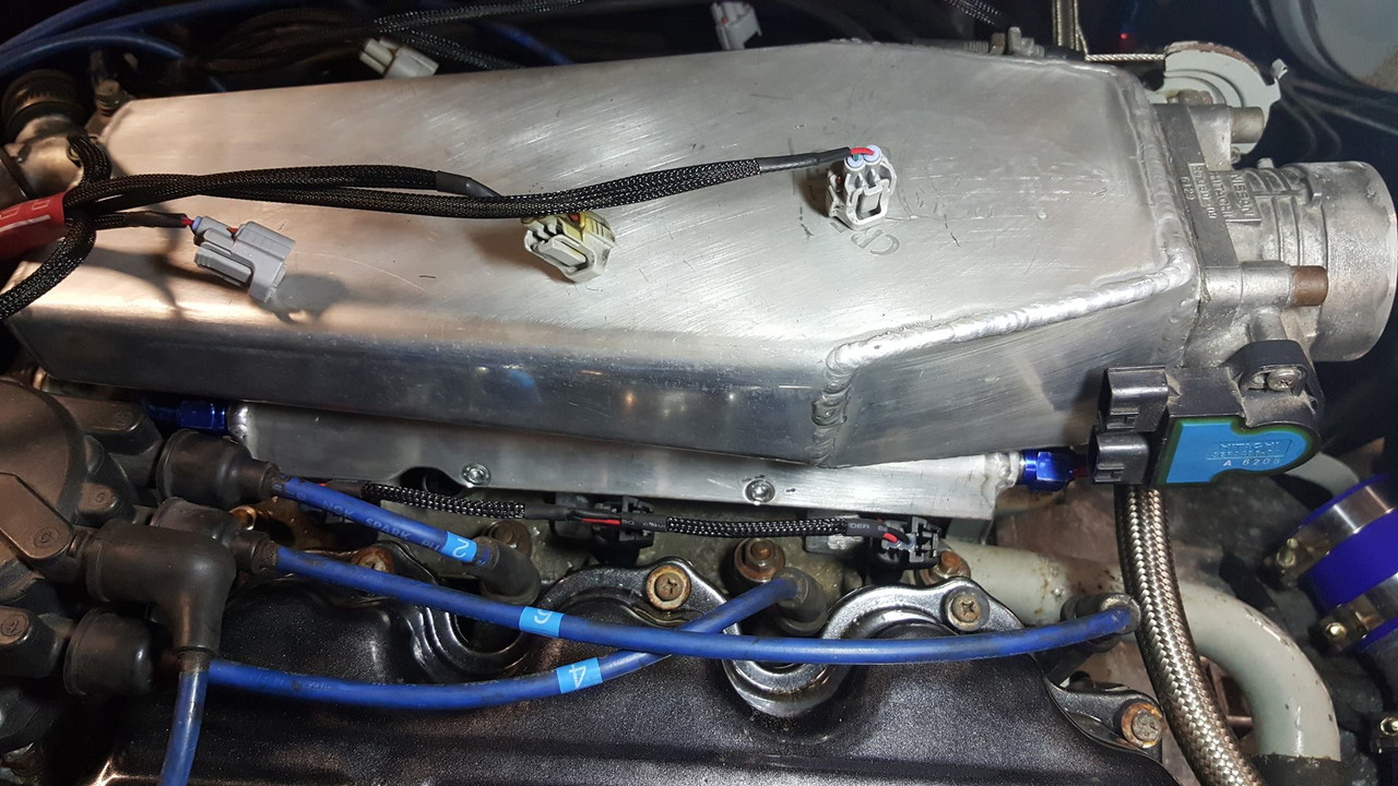

to install the 550cc injectors i had to change the pigtails, i had already done these pigtails to work on my Z which had a vg33 on it so the spacing was right and the wiring was still good so all i needed to do was solder them in and loom it (which you actually have to do in the opposite order with this loom, i totally didnt have to redo the solder because i forgot to put the loom and heatshrink before soldering, i would never do that)
i have no idea why i did the injector wiring the way i did before, i ran 3 different pairs of wires ALLLLLLLLLL the way from a junction like 2 feet from their termination points. i cant remember if there was a reason to do that but i also cant think of one so maybe i was just stupid at the time which is possible cause im still pretty stupid right now... anyway i had to add some wire to get the pigtail segments to reach. im not really worried about having a bunch of splices because they were all soldered and then adhesive heat shrinked so they should be waterproof and very secure (and should last longer than other areas of the harness will anyway) but the next harness i do im going to keep this in mind and if its going to be batch fire im running ONE pair of wires per bank all the way to the injectors lol
heres the finished front injector harness. i installed the fuel
here is a video of the car running, it sounds like its actually on all 6 cylinders now even though its on less than 40psi of fuel pressure lol i was gonna try turning it up but i noticed a leak in one of the fittings and i had to leave so next time im up at my garage ill mess with that and get to tuning and seeing if i can really get the car running the way i want. ill probably drive it a little bit now since i *think* everything is ready for that and then probably in the immediate future ill be possibly redoing the engine mounts and front transmission mount and then ill definitely be building a set of turbo headers.
