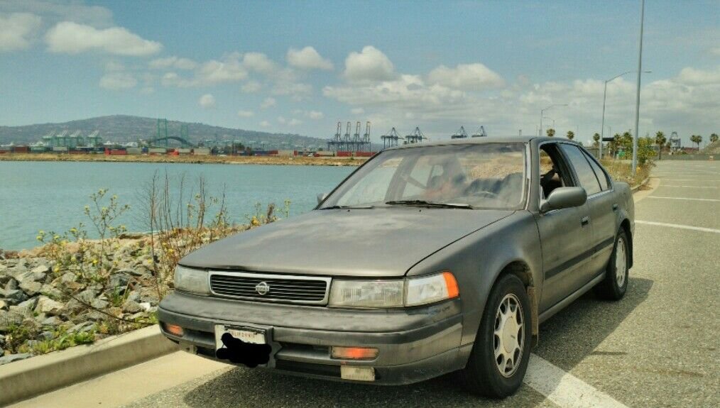

Heres my ugly beast those are the fog lights i have

Then put in the relay? I believe it's a blue relay but you may want to confirm first before you put in the wrong one.
