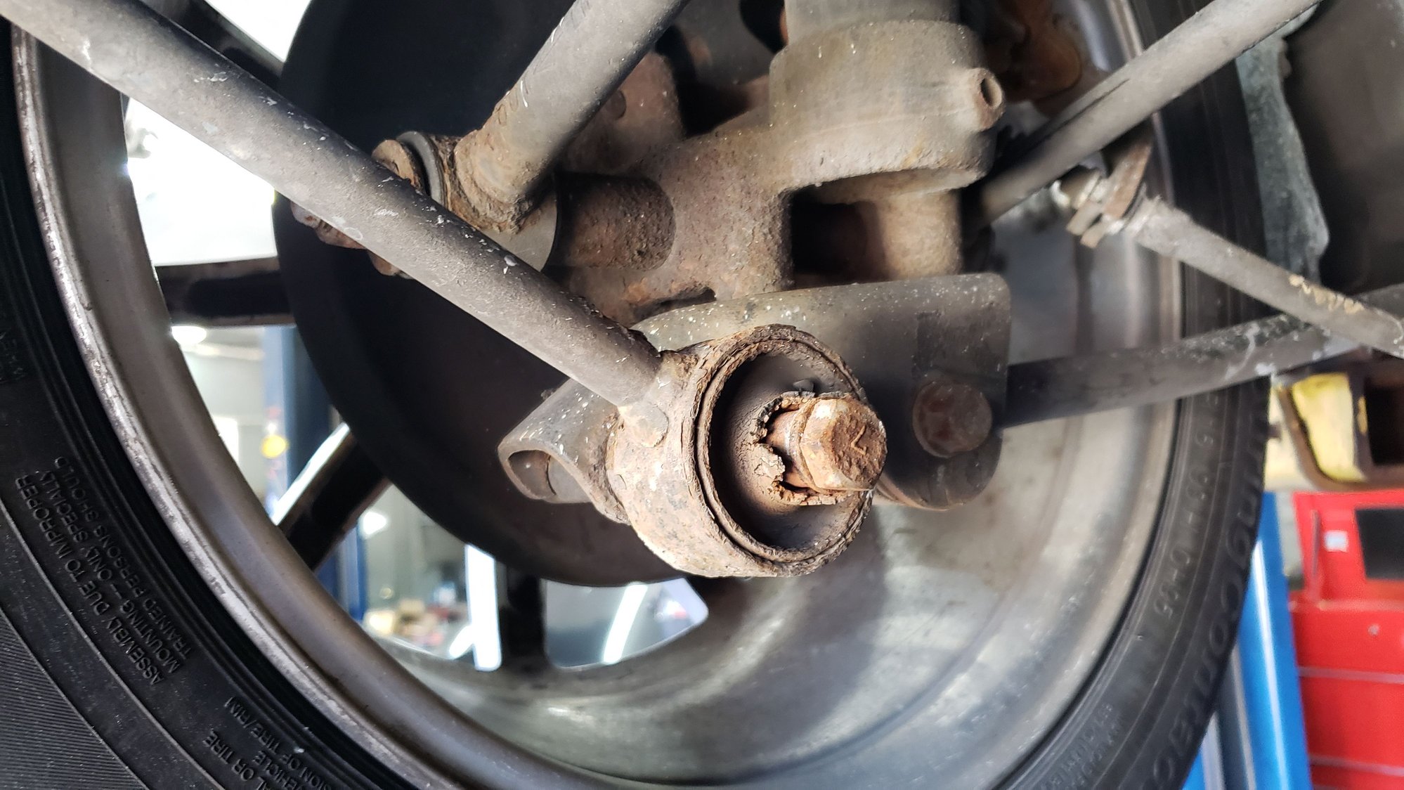

Turns out my rear stock sway bar is rotted out
So my best bet would be to install front and rear ST sways.
