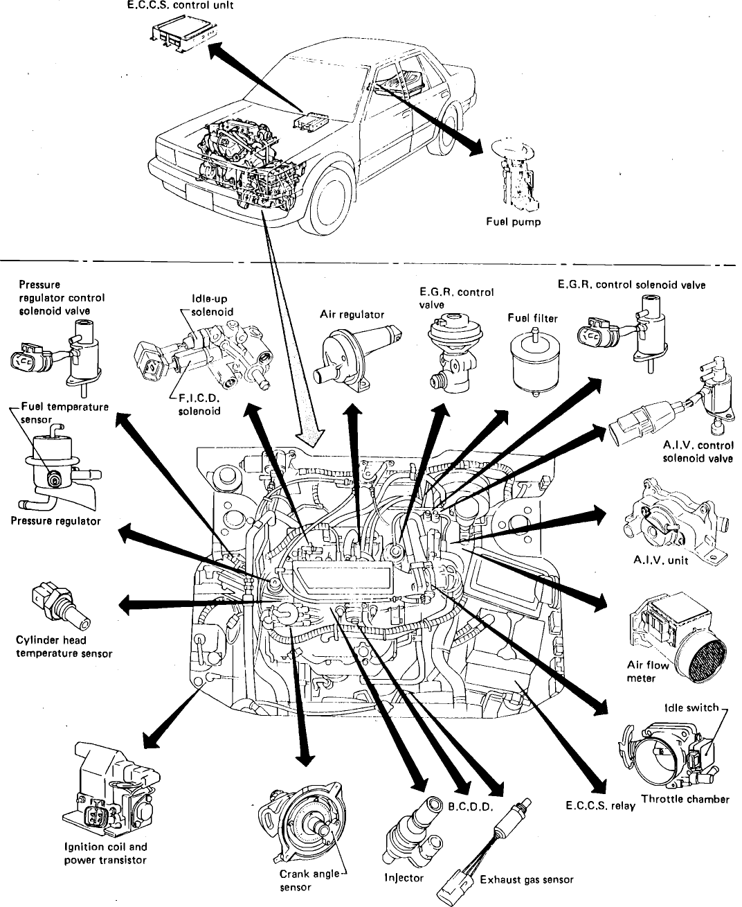

VG30E the crank angle sensor is in the distributor itself, when it gives out you basically just replace the distributor. Far easier than taking the dizzy apart to replace only the sensor unless you're super mechanically inclined
