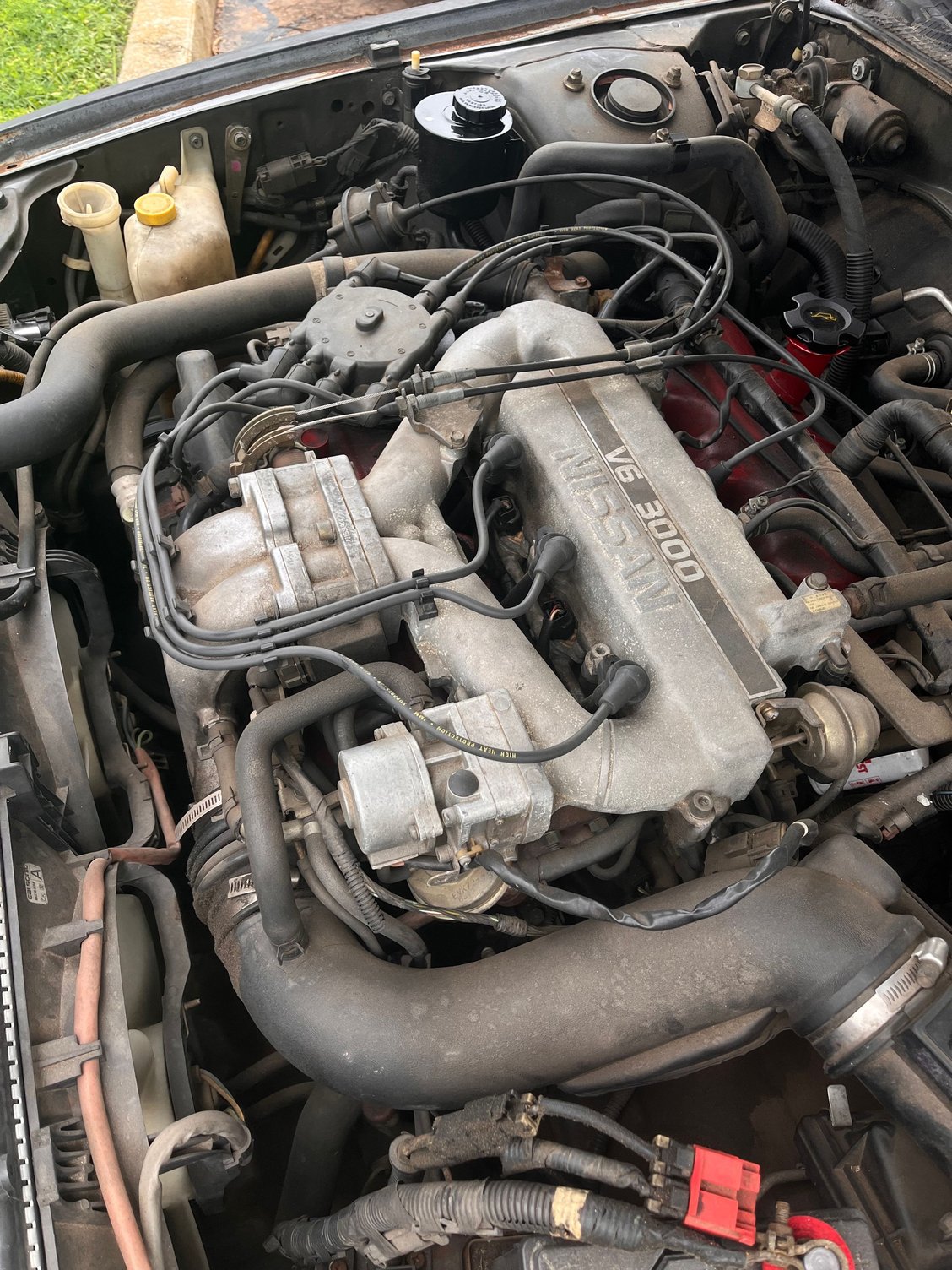

Where is the cam position sensor location on my 1993 Nissan Maxima GXE 6 cylinder car?

Inside the distributor. You'll need to remove the cap, rotor, and some screws to remove the cover.
