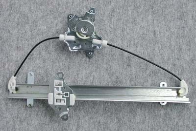

I was thinking about cleaning the cable sleeve that drives the bracket up and down. Cleaning the brake cables on my bike really works. Also, any eletrical connections should be checked. When I had the driver side window control apart following the LED mods instructions, I found all sorts of gunk and cleaned it out.
http://www.a1electric.com/images9/1330412.jpg
