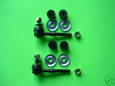

Thanks. I replaced the bushings months ago, I was asking about the actual stabilizer end links themselves.Originally Posted by njmodi
Your swaybar bushings, and endlink bushings are most likely in need of replacement (based on age/mileage of the car) - so definitely do that.I would replace the inner and outer tie-rod ends as well.
You can try seller pedro-r on ebay or PM "internetautomar" (not a typo). Brian (internetautomar) has at least as good prices and excellent service. He's always hanging around the 3rd gen forums - I bought everything (LCAs, tie rod ends, etc.) off him.
Quote:
$24 + shipping on eBay.
If you can afford the extra 40 bucks I would recommend it. Whe I replaced my LCAs, I had to replace one end-link because we couldn't get it off the old LCA - the bolt would just spin and spin because of the ball-joint. I wish I had known how bad a shape mine were in to start off with, I would have just bought new ones right from the get-go.Originally Posted by VQuick
Thanks. I replaced the bushings months ago, I was asking about the actual stabilizer end links themselves.Senior Member
