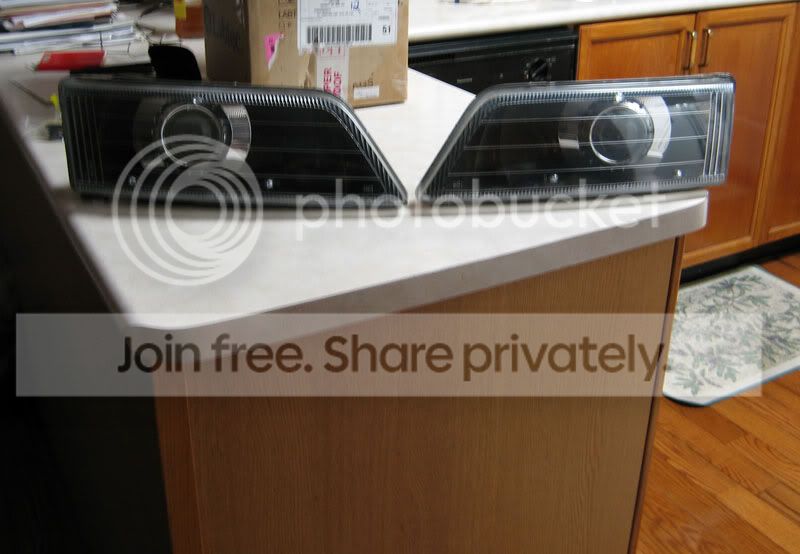

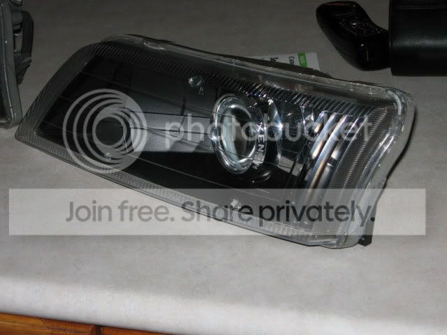

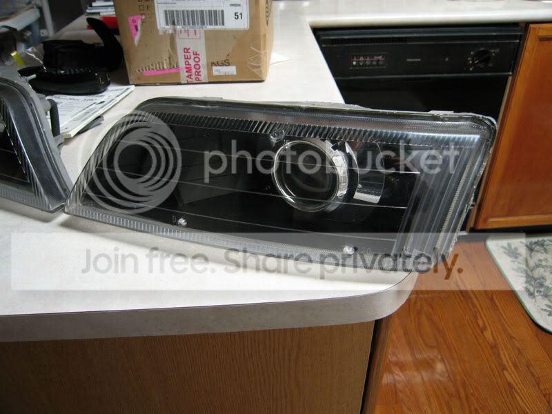

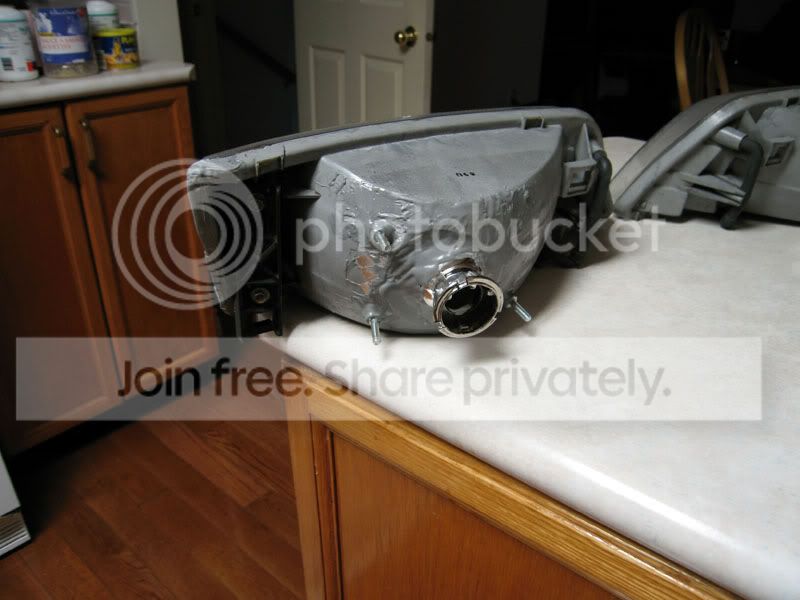

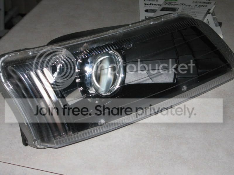

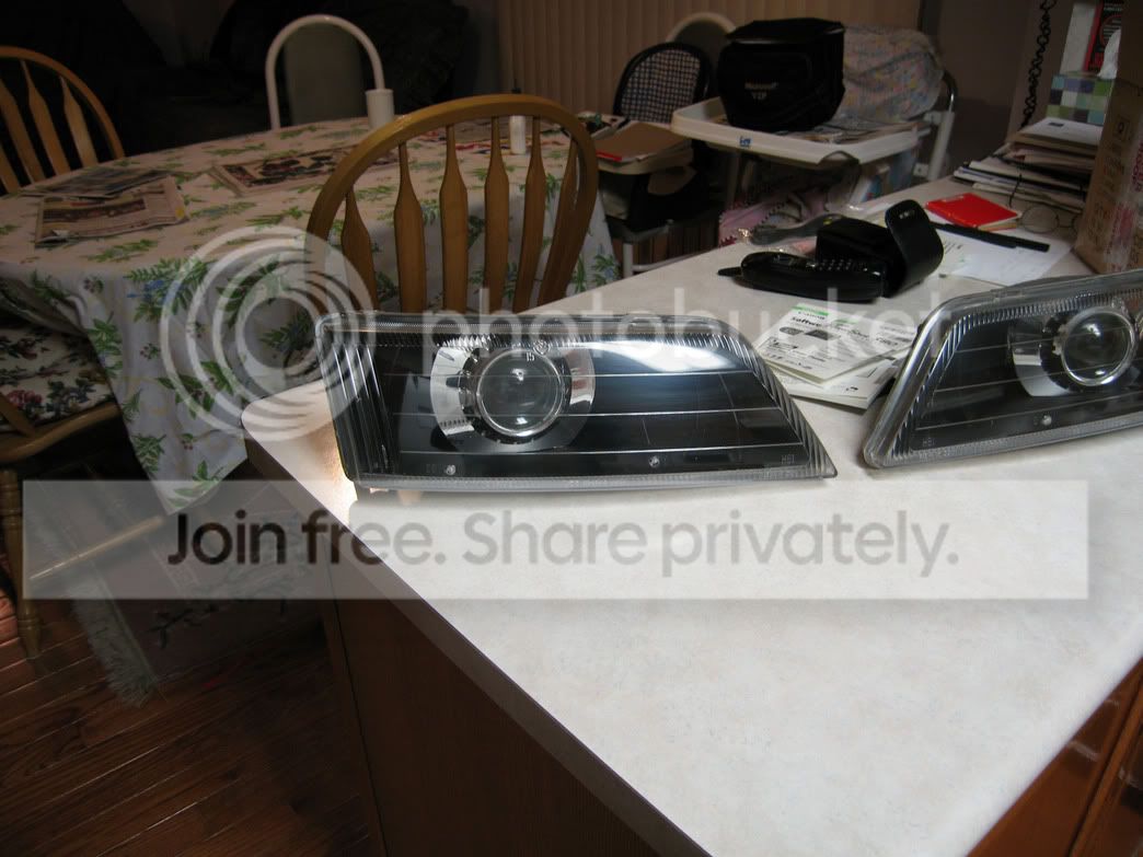

Took some time and patience, but it is finally done. Did it in little steps over the last week or 2.
I am using Matsush!tsa Ballasts from a 2004 Nissan 350Z to power them that are currently wired in my car. These projectors will be paired with a set of D2S Philips 4300k HID Bulbs. The Projectors are Bosch single xenons from an E46 BMW 3 series. I also used the bezel from the E46 BMW too. I had refinished the lens of the oem headlamps (they were old pitted/sandblasted headlamps from a '98 ). Tell me what you think...

wetsanding from 400 grit to 2000 grit then buffing using pro-grade 3m compound... look here: http://forums.maxima.org/showthread.php?t=375480

i used dupont high temp flat black paint

setup cost was around 400cdn
thanks for the comments everyone. i will post pics of them installed in the spring once i get my stillen front lip painted and installled and get the car cleaned. winter is starting to get real rough around my area, so i do not feel like putting anymore mods on the car yet.

Damn, I posted D2R by accident...I meant D2S. Let me edit my original post. I have a set of D2R's from a 350z which I will be selling soon.
