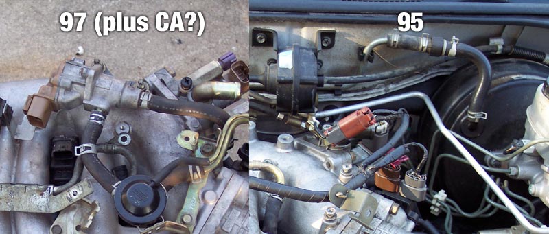

Does your extra stuff look like the one on the left?
If so, we need to talk
well i dont think so the stuff im talking about is right at the front of the engine one is the Map/baro sensor it has one big line from the bottom and two nipples for a and b galleries on top. the other is a little to the left right in front of the exaust it has the same type of setup with one big line from the top that connects somewhere and two lines at the top that go into a and b galleries. the one in the front doesnt have a electric plug from my harness so it is unusable and i think i need some hoses to make the two lines going into it come over to my map/baro sensor.

What you're describing is exactly the difference between CA and non-CA emissions (based on my personal experience, and diagrams I've seen); I just took a picture of the top of the plenum instead of the front of the engine where the gallery is.
Your front gallery has a few extra nubs, an extra tube, etc - as well as the extra sensor.
My statement about switching back to the original emissions came from experience. You can't power the extra sensors, you can't read their signals (even if you did power the sensors), so they're 100% an impediment to getting the car running smoothly.
Obviously there are others with more Maxima experience on this board, and hopefully they'll chime in one way or the other.
YMMV SPSFD

I did the same sawp. I did a 97 into my 95. You do not use the MAP/BARO/ Boost sensor on the 95, I just have mine Zip tied out of the way. Also you do not use that emissions stuff that is posted in the pics. Just take it off, you don't have any where to hook it up anyway. Just look at you 95 engine and make the 98 engine look like that one (does that make sense), take things off or swap things over. You can PM me if you like, I did the swap a few months ago now, so its still fresh.
