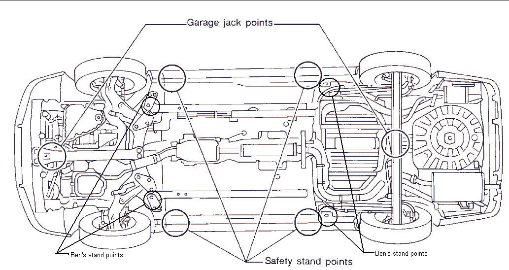

the safety jack point in the front are bent. do you folks use another area to jack stand. i know about the cross member for the hydraulic jack. i need to know about using the jack stand.

Ben's stand points are the ones I use, the front ones I usually put on the bigger metal piece but you get the idea.

what do you mean?
Originally Posted by Fr33way
bigger metal piec .

i hate how those thin spots bend. but i have a lift now, and it doesnt bend anymore.

Ben's stand points at the rear, look awfully close to the vulnerable handbrake cables!

I cut a piece of 2x4 about four inches long and cut a groove in it with a table saw wide enough to fit the metal channel. By using the 2x4 with the groove on the factory jack points, the metal goes in the groove and it can't bend out of shape. They sell these as well, they are rubber I believe, and have a groove for the channel. For the money they charge I just copied the design with 2x4s. No more bent up jack points and can be used over and over, I keep mine with spare tire or jack.
