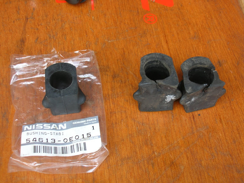

Got it all changed out to MOOG without having to loosen the buching nuts. I just pulled the sway bar up a bit and had more than enuff leverage to get it out. BTW MOOG ships their links with 15mm nuts rather than 14mm.
old parts

Just replaced mine yesterday. While I was there I also replaced the swaybar bushings. As it turned out, the swaybar bushings have really worn-out, resulted some clunking noises... Extra two bolts and $8 parts, definitely worth for the effort.
Here is the picture of new and old bushings.
