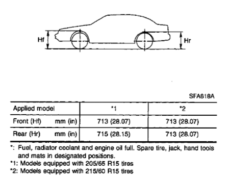

That's not an attachment, if that's what you were attempting to imply. That's just linking it inline.
This is an attachment.
