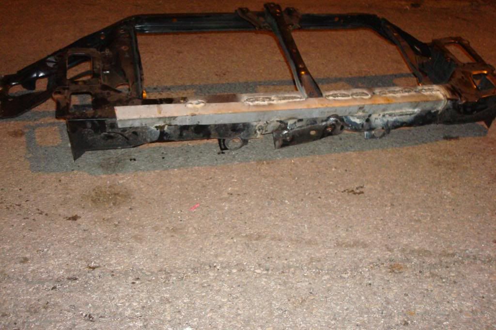

Stick to OEM, I replaced mine 3 times cuz I kept going cheap... first I got a $30 from Keystone, then I got one for $50 from www.certifit.com each one lasted me 3 months. Lastly I paid $337 for a OEM Nissan one and I've had it over a year and it still looks new. Save your time and spend a few more bucks on the nissan one. I did not replace the bottom portion but the entire thing.
My cousin got in an accident with her Max so I'm gonna be replacing her support sometime this coming weekend or so. I justmay end up making a write up with pics and video if there's enough demand for it

Just to show you what a support from Rock Auto or any other aftermarket place will look like after 90 days. Dont waste your time...seriously. Fitment isn't all that great either, you need to bang here and there with a hammer to make stuff fit. When I did the OEM one, all I did was bolt it and everything aligned nicely and straight.
[/IMG]

Listen to me and do what I did. I am not sure which dealer you called up but they carry the lower piece only. That is all you need unless you were in previous accidents and the upper part is damaged as well. This was my case and what I did was buy the lower piece from the dealer and buy a full aftermarket one and detach the upper part to use with the lower OEM support. Still works out wayy cheaper than $500. If they don't want to give you the lower separate, call another dealer or as I see other orders on here do, just PM DaveB. Good luck and post if you need more help.
ColumbiamMax posted great pics as well even if you try to fix it as I did as well....

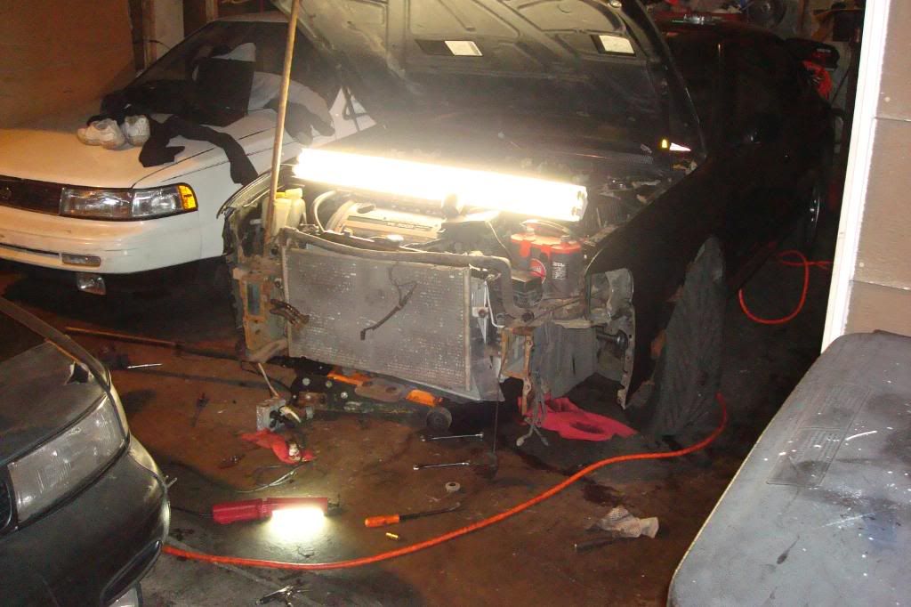

Haven't checked this in a couple days, but GREAT posts all. Thank you. Those pics go a long way John, I appreciate it.
I was only considering getting the whole rad support to avoid breaking welds and re-welding the lower piece. My local dealership in Guelph, ON quoted $471CDN for the entire support and $291CDN for the lower support only. Courtesy does offer these at a better price but shipping is $60 or $240USD for lower and whole, respectively.
After conversion and duties the lower support from Courtesy isn't MUCH cheaper than just getting it locally.
So OEM it is. I'll order it up and rip everything apart this weekend, maybe snap a few pics to post if you guys are interested. I know I'll find out soon enough, but can you guys confirm if the WHOLE rad support is bolted or welded to the rest of the car? I'd like to get the whole thing off to do the lower support swap, and wreckers have told me welded. Just trying to plan out how much beer I have to get for my one friend with a welder.

Yeah definitely you need a welder to join it. It welds on by the corner lights on both sides and also down at the bottom. The reason I say go that route is because the guy I let do mine was able to do this without disconnecting the radiator or the condenser. So no need for new freon or antifreeze drain.
