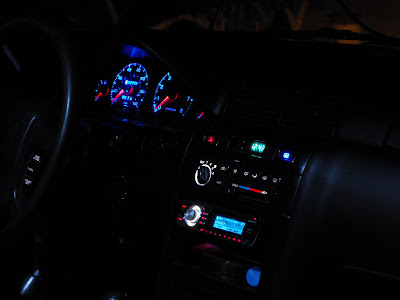

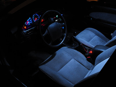

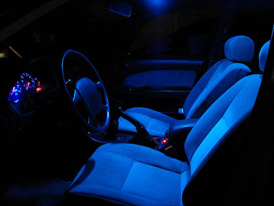

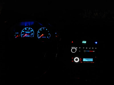

Maybe I'll take some updated photos since these are pretty outdated

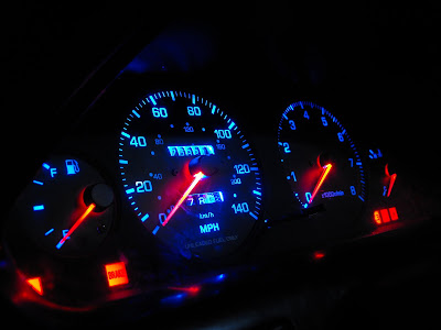

Reverse indiglo gages with Led needles. (Needles have been red for at least a year now just never updated photos)
1 3mm Led behind each small needle
2 3mm Led behind each large needle
3mm Led for turn signals. (sanded off the green and taped off the arrows from behind)
EDIT: wow just looked at the mileage in this photo. I have just over 229,000 now.....

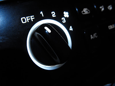

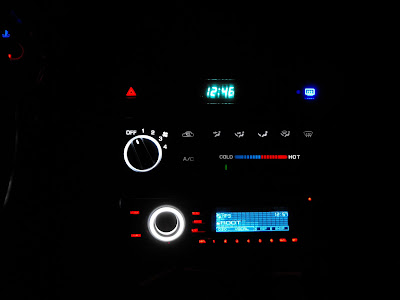

Climate control and defrost/hazard buttons.
3mm blue Led behind each button to provide evenly lit buttons
3mm red Led behind each indicator behind buttons
3mm blue Led behind "Cold"
3mm red Led behind "Hot"
4 blue 3mm Led's behind fan speed
3mm blue Led in Rear Def with 3mm red in circle indicator light
3mm red Led in Hazard button (blue in this shot but has been changed)
JVC headunit is gone have the Pioneer fh-p8000bt double din now. All blue
Layer of red cellophane on clock (makes it white)
Layer of blue over that (makes it a cyan color that matches the reverse indiglo gages)
3mm blue leds in all window switches
Led's in door handle pockets are gone and i30 chrome door handles are in now
Neons and other rice once on the car all gone thank god.
Also have 5mm blue Led in keyring
3mm Led in dimmer control
3mm Led in Security Light
Two 3mm Led in Cruise Control switch
Two 5mm Led in autotragic shifter

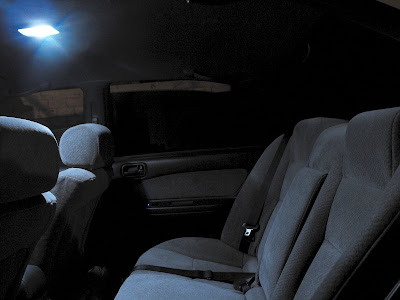

8 bright white superflux leds in Dome light
6 bright white superflux leds in Map light
4 bright white superflux leds in each door light
JBL amp mounted in rear pass through modified with 5 total 5mm blue Leds
I'll try and update with some better pics

Thats what im talking about, I want that...... did you add resistors or no? and where did you get those leds?

Pavel, your climate control makes me want to rip mine out and re-do it. :-/
I got all of the LED's on ebay. Most i got some time ago from a user named cwithk. They all came with resistors that allow the Leds to be used with 12 volt applications. Each Led has a resistor in all cases except where an led already exsisted (the indicator lights, temp slider, window switches)
Since the climate control is pretty crammed I wired two sets of 3 Leds in series behind the six buttons. I used an online calculator to determine the proper resistor and picked those up from radio shack.
Ha thanks. I've had mine apart too many times to count. Originally I had an all red interior using bulbs and stain glass paint on everything. I ditched that climate control for another that I simply replaced the bulbs with LED's. The light output wasn't even and I decided to fit an LED in for each button. The first try ended up with me frying the climate control. Now on my 3rd climate control I finally got it right.

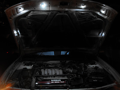

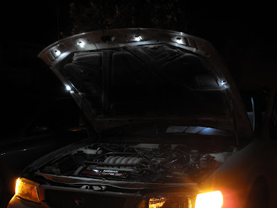

i just finish with the LED mod in my car... now i can say that all the interior lights are LED
tell me what you think about it
go to my page if you want to see them ledxury.blogspot.com

Wow they look great! I'd like to know more about what you used for the cluster

+1
It's like the re-incarnation of Ilyak's cluster.

Your gauges look great, do you want to do mine?

Just finished my climate control and door switches. Only got a pic of the climate before the battery on my camera died.
