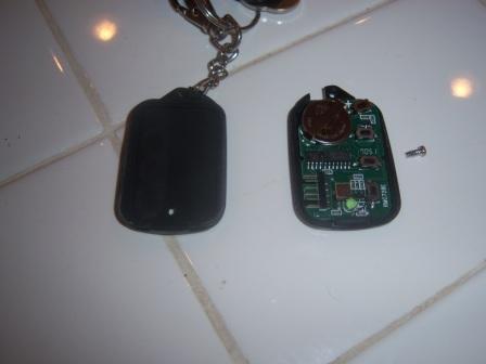

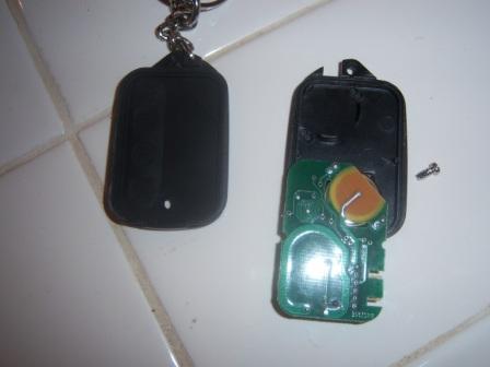

this may sound silly but, do you have pics of it apart showing the board? i have a goofy project i'm up to and would like to see the chip design.
Hey mighty. Sorry for the delay. I have been pretty busy and not even on here that much lately. I also got your PM. I do not have a picture of the remote opened up. But I'll try to do that for you in the near future.
mightyMax, does this help?
