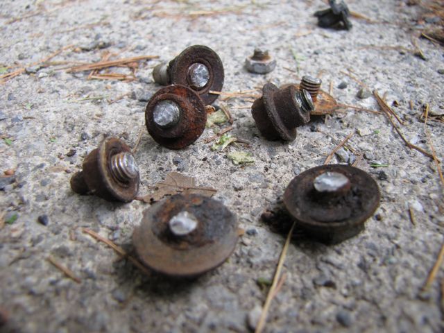

Well, I finally started the project of replacing my radiator support after all these years. I figured it was about time, given the level of decay down there. I've got everything that can't be cut off the car removed, and I'm waiting for a free day to start removing the rusted out support.
Speaking of rust, every other bolt seemed to be so rusted that it twisted off...regardless of how much penetrating oil I used. Most of them are easily replaceable, however the nuts securing the headlight housing (3 out of 4 anyway) decided to take the studs with 'em. Any way to replace the headlight mounting studs without replacing the entire assembly? Maybe new headlights are in my future.
From looking at the support, and how it mates up to the chassis, I can't figure out why welding is even needed. The support seems to bolts up pretty damn securely via 5 heavy duty bolts on each side (3 for the tow-hook, 2 for the bumper support). I guess the lower support should be fastened to the upper support, though the joint on mine is rusted entirely with no apparent issues.
Were the original spot welds put in just to make assembly easier at the factory? I plan on putting a few welds in here and there, but I can't help but think they serve no purpose.
A few pictures; hopefully I can get back to work on this project within the next week or two. I plan on removing as much rust as possible, and painting every piece of bare metal...any suggestions on paint?
Attached Thumbnails Lower radiator support replacement-img_1177.jpg   Lower radiator support replacement-img_1184.jpg   Lower radiator support replacement-img_1197.jpg   Lower radiator support replacement-img_1200.jpg   Lower radiator support replacement-img_1211.jpg

Ho-lee-sheet! Thats cancer for you.
If you have a tap and die set, drill out the broken bolts and re-thread the holes. Easy peasy.

I'm about 60 miles north of NYC, so I couldn't begin to recommend a shop for your area.
Hopefully I'll be able to drill/tap what broke, but given the ammount of rust I may be forced to use nuts/bolts/washers a lot of places.
