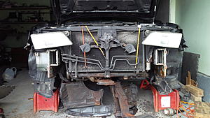

As far as I got today. Used a small and a bigger drill. As you can see lower left, no using a bar or welding. This lower was toast..
Not sure how to get at this. Drill kind of works. I'd hate to have to evacuate and move AC stuff. Is there a better way?
Old Nov 29, 2017 | 02:21 PM
  #102
rodent_infested_03's Avatar
Joined: May 2017
Posts: 222
From: Hudson, NH
Wonder if this will be easier on the metal, easier to use..

Old Nov 29, 2017 | 08:49 PM
  #103
svezarov's Avatar
Joined: Jan 2004
Posts: 104
From: Ottawa, Canada
I tried a drill with similar shape, but it didn't cut as good as the normal drill, so did most of it with the normal ones. Here is your target - you have to see the 2 Ps
