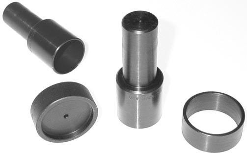

a drift is a tool used with a press usually, it's just a cylindrical piece of metal. here is a picture of some different drifts.
if you can find the right size socket or drift it will make installing the seal much easier (but still not a piece of cake so take your time).
