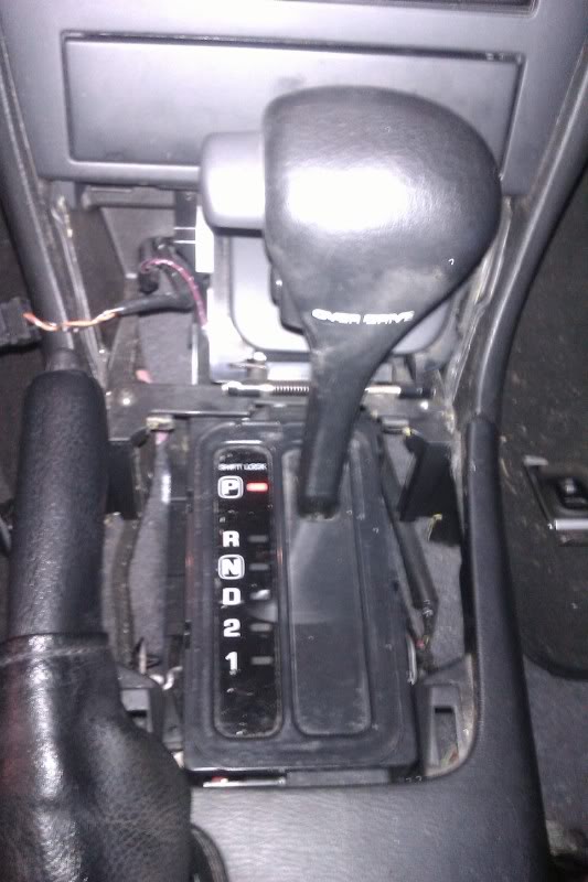

Ok I'm stuck and need help liek a n00b.
I got the shifter trim put, but how to I access the T10 connector for the illumination for it?
Her's where I am:

I see no screws holding this in...only two tab things on the right side but I pulled them up and nothing happens...

Feel underneath and you'll find the bulb base with the 2 wires leading into it. Twist and pull.

GOT IT!!
Thanks...I thought I had to take the other part out...

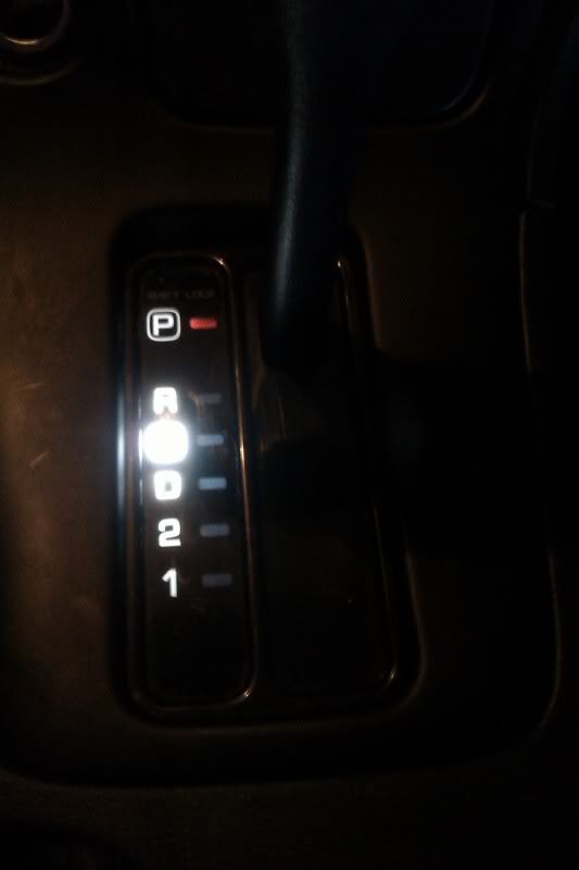

the bulb is located under the "N". The connector is oriented East--West. Twisting the connector counter-clockwise to North--South will let it release. I just used one of the T-10 bulbs I had left over (WLED-x6: 6 LED T10 Wedge Base Bulb), and below is the result...you can see the hotspotting on the N, right above. Mounting it back was a b!tch but I finally got it.
I plan on ordering one of the T-10 base 360* HP LEDs in the Cool White to make it even and avoid the hotspotting.
I also did the following:
Dome light arrived (36SMD w/ festoon adapter):
Key ring LED:
So I ended up removing the whole steering column trim since I was a dum-dum and didn't actually realize the key ring area pops out. Whoops :-)
I also re-installed the instrument cluster LED that came loose last week.. fulll illumination FTW!

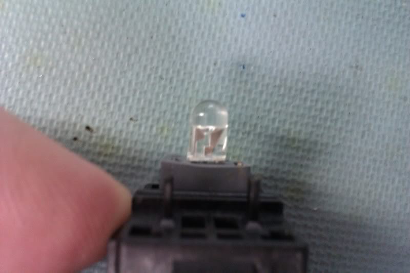

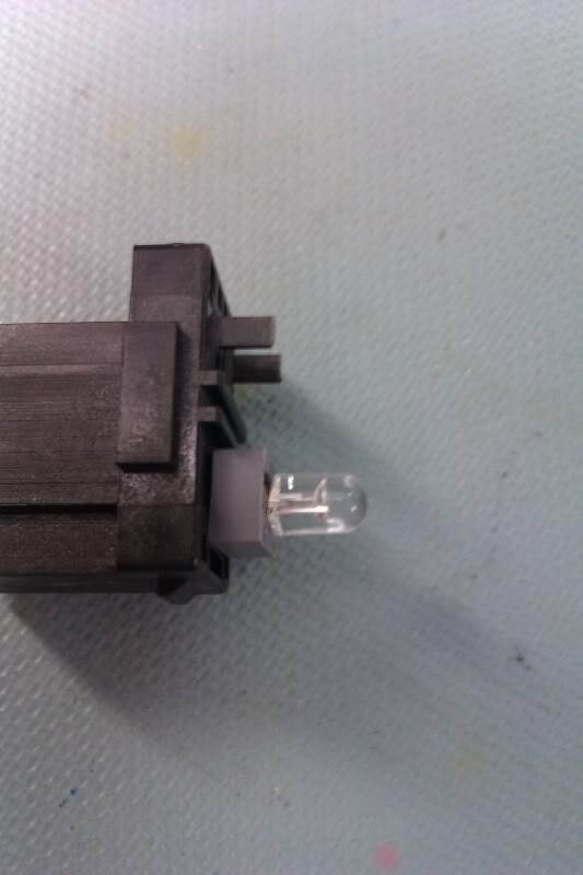

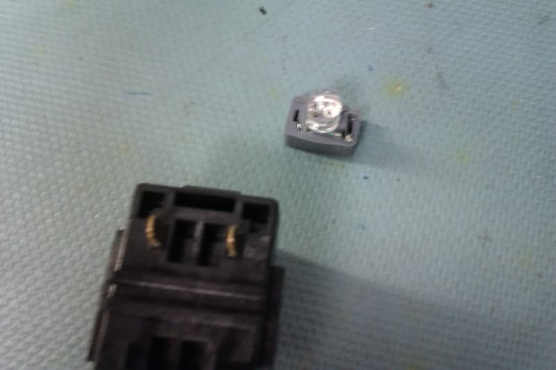

Security light...
unclipped and removed from the housing:
Another view (this shows polarity)
The gray rubber piece just slides right off from the black piece...
It IS an LED, a red led. There is NO FILM covering the little window so if you throw any color LED in there it will show that color. I didn't disassemble further, but you can probably get away with bending the leads in.
There IS A RESISTOR ALREADY IN PLACE, if you look closely @ the above picture you see a bit of blue...this is the resistor. It's a 680 Ohm resistor (I measured it). So it should be simple to swap out another component LED. 3mm or 5mm, either one.

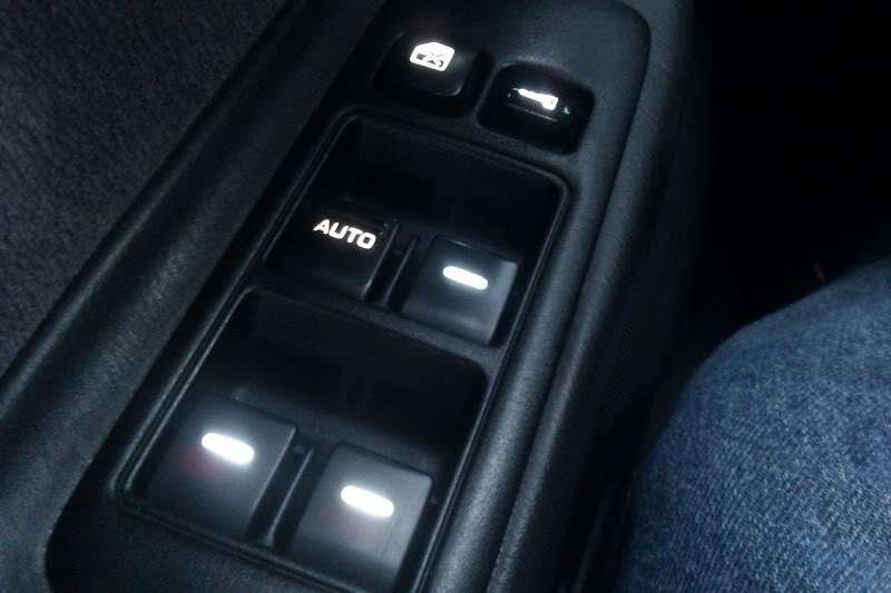

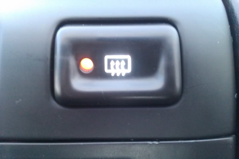

All LEDs on the door switches - DONE
Rear Defrost LED - DONE
(For this one, I left the standard orange light that illuminates when the defrost is on, but I swapped out the backlighting for white LED...the backlighting bulb was out anyhow).
Going to order some LEDs for the manual climate control tonight...going to try and use 5mm 360* LEDs from SBL and solder resistors, using stock housings on 'em
Old Feb 22, 2012 | 05:45 PM
  #145
Amerikaner83's Avatar
Posts: 11,386
From: WA
^^^Thinking of re-doing this...with a 1k resistor instead of the 470 ohm I used...way bright. OR I could use a 3mm amber or red led here as well...what do you guys think?
Thinking of changing these out to blue, or maybe to LEDs that are not quite as bright...? Will decide after driving for a few nights.
edit: so now I have to change out the Hazard switch as well LOL compared to the defrost switch I can barely tell it's illuminated :-) I'll probably throw a orange LED with a 1K resistor on that baby.

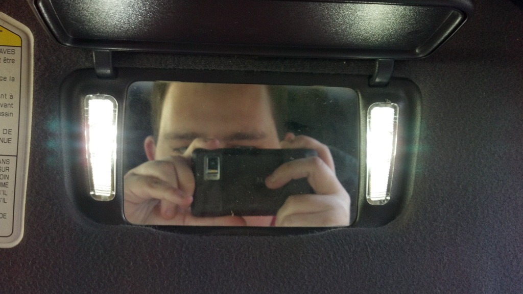

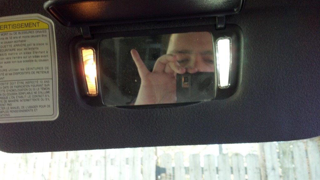

NEW INFORMATION
Vanity Mirror LED's
I will have to confirm that these fit 95-97 cars (Im pretty sure they do)
Here are the LED's I ordered (31mm Vanity mirror bulbs...xenon white)
http://www.wardenjp.com/stores/festoon.html
You can also get NEO-x bulbs from this site as well ($2.80 for two pieces)
http://www.wardenjp.com/stores/neowedge.html
And here are the pics
LED on the right, OEM on the left......pinky up like a boss
both LED's in
FIN
A mini write up for the vanity mirror bulb change will be up soon

quick question , it has been awhile since I had the front door panels off. I already popped out the rear window switches easily and soldered new LED's in them, but both front switches do not want to pop out easily like the rears. does the panel come off first then a screw? of do they pop out form rear to front like the rears.
Old Sep 3, 2012 | 11:23 AM
  #159
Posts: 11,386
From: WA
th front window switch bezels pop out from the FRONT of the car....while the rears pop out by prying the rear of the bezel up.
Old Sep 3, 2012 | 01:14 PM
  #160
flynlr's Avatar
Joined: Oct 2002
Posts: 364
that worked just fine thanks. as i was soldering the led's into the front switches I happend to notice all the resistors built into the switches where on the negative side of the LED. they all worked fine but when doing the dimmer/security/hazard/defrost LEDs i soldered the resistors onto the pos side of the LED. guess it works both ways?. "LED NEWB" here
