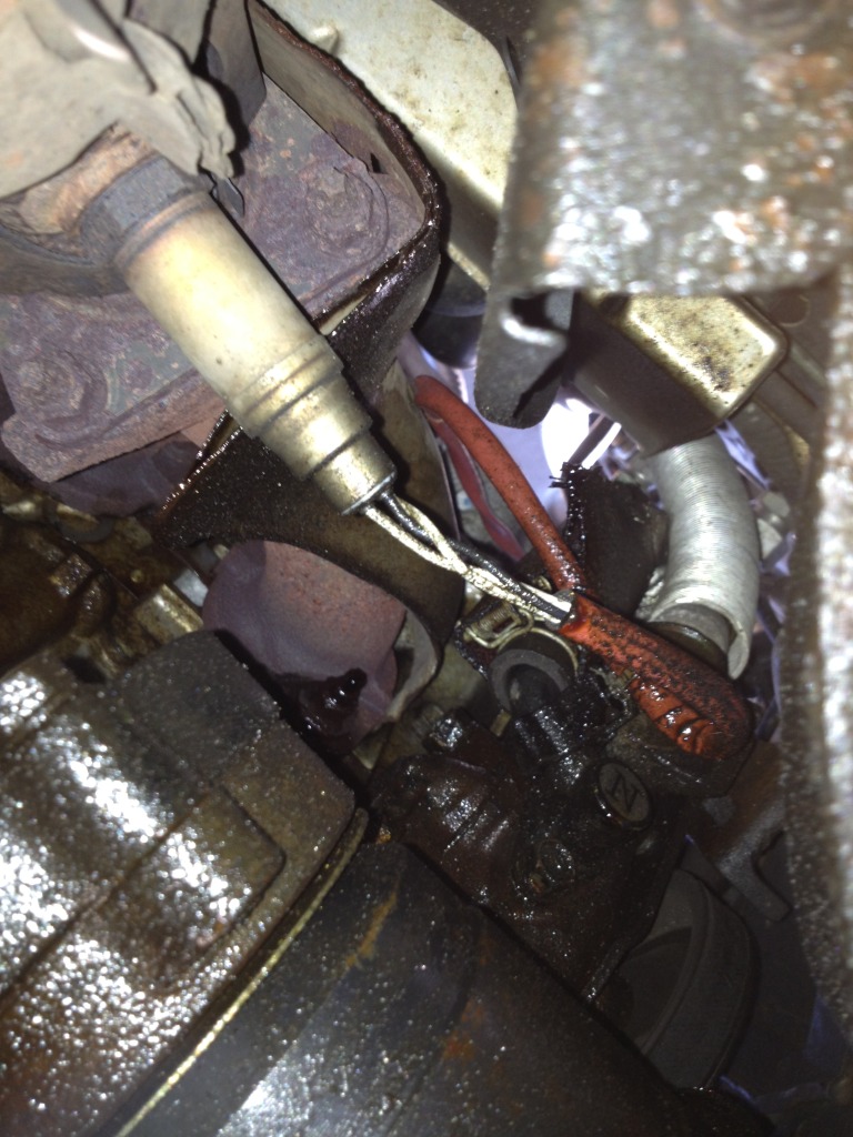

i replace my radiate and all my hoses plus the thermostat now my car leaks and it doesn't leak from the hoses or the thermostat i check all of those, i got under the car and found my passenger side axle all wet and the rear of the engine we and dripping if i fill up the reservoir tank it drains it to the minimum line and if i fill the radiator it will be drain in a day or two. i got under and took some pic maybe some can help and see whats back there that could be causing the drain so fast

These pics look like rear valve cover and power steering return hose are leaking.
Agreed. And coolant leaking from front, from looks of video.

From the information im getting theres a great chance it's my water pump n after looking at the pictures it does look like my rear valve cover is leaking how hard is to change the seals?
