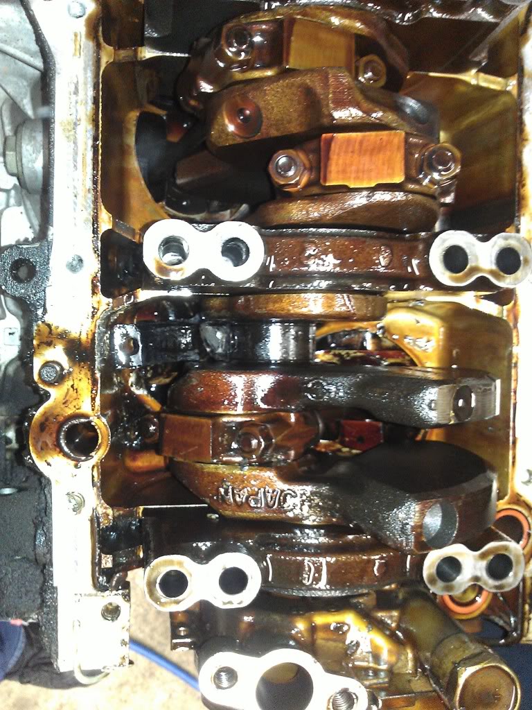

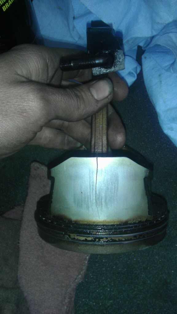

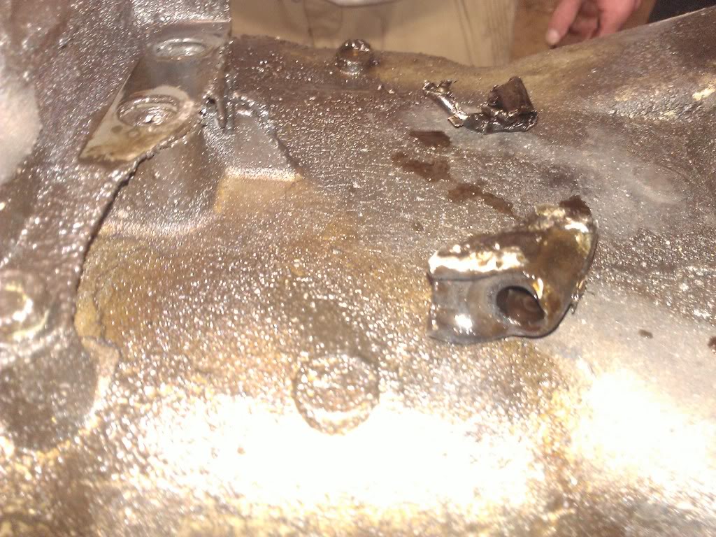

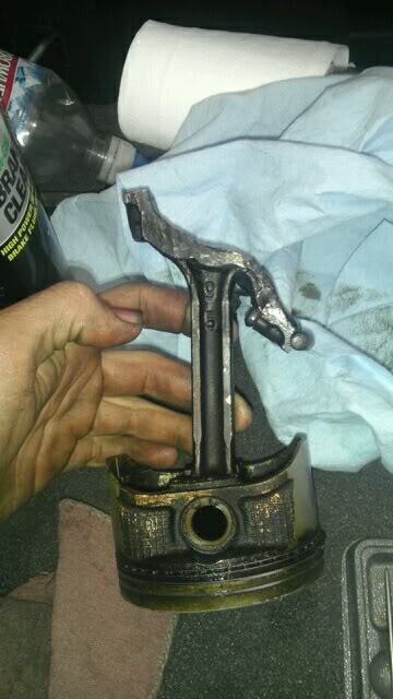

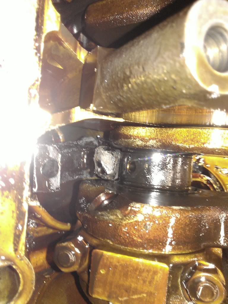

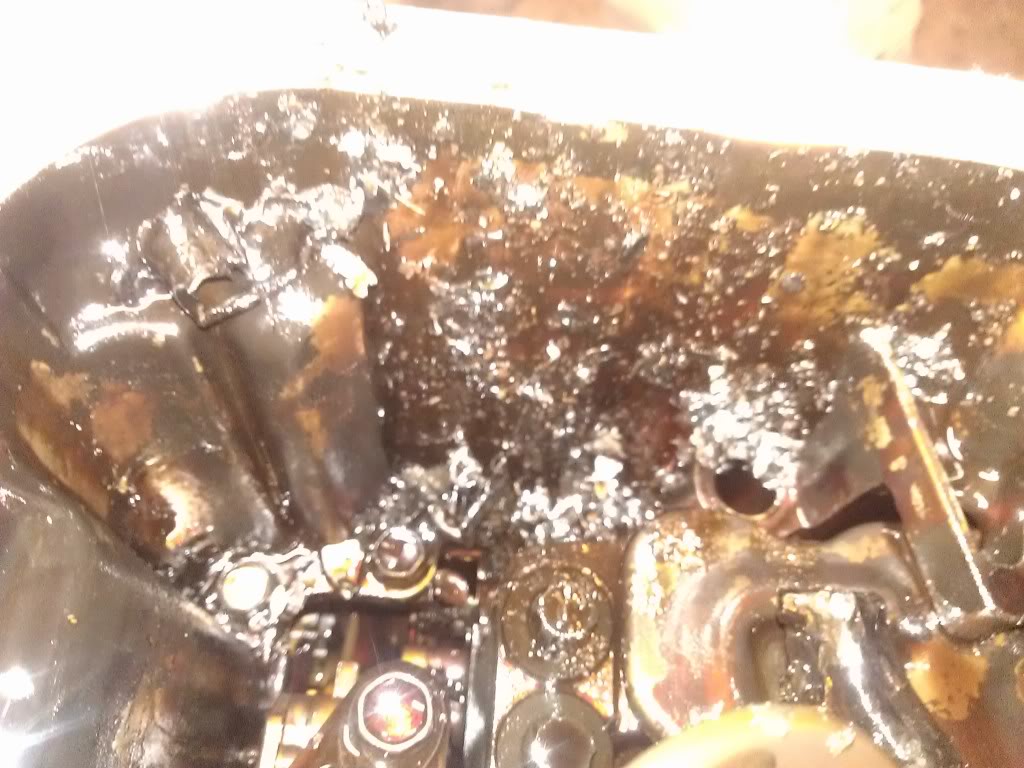

This is not my Maxima. My friend has a gold 96' SE Maxima with an auto tranny. He was racing another car when he blew his motor. It was blown due to lack of oil. When we drained the pan before removal it had a quart or less of oil in the crank.
These are pictures of the carnage. He intends to fully rebuild the VQ30 and reinstall it. He also has a VQ35 that is going to be built for boost down the road.
Damage was a destroyed rod on piston 2.
