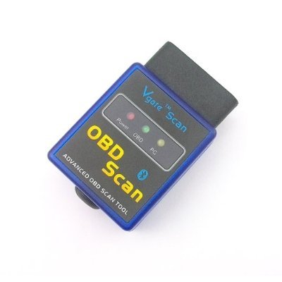

Which OBDII adapter are you using? I tried this ELM327 V1.5 bluetooth adapter but it has limited features
I'm using it with the torque SW application I baught for $5 from google play but it doesn't get all the readings I want.
I contacted the ebay seller and requested to trade it for this ELM327 because it claims it works with all OBDII vehicles

I'm using an ebay ELM327. Which readings are you missing?

It won't calculate MPG. I input the VQ 3.0 engine profile. Any other info it needs to Calculate MPG?

I use the same adapter with my Bluetooth laptop with a program called CarPort and wOBD. Works great. I don't have an android phone but it is still a good alternative. So far I have been able to clear codes and check CEL's which is all I really needed. It even does a bit more than I expected for the price...

I got the torque SW application to calculate MPG on my droid smartphone using this ELM327 I got for $11 on ebay.
In the torque main menu you first have to click 'Vehicle Profile' and input the 3.0 engine and vehicles weight. Now click 'OBD2 Adapter Settings' under the main menu then scroll down and click on 'Enhanced MPG Calculation'.
The readings aren't as fast and big as on my SCANGAUGEII but for only $16 total ($11 elm327 + $5 Torque SW application) it was good enough.
EDIT: When I fill up tomorrow I'll clear the data so it can calculate the AVG MPG I get on that tank alone.
