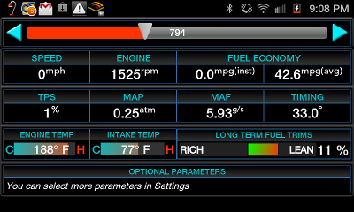

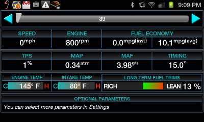

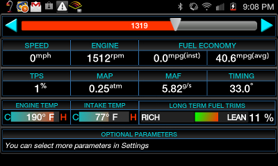

Here are some screenshots I took from my phone using OBD DroidScan Pro for Android. This hopefully will explain what I'm talking about...
This is what the beginning of my trip looks like. When cold, I feel acceleration drag initially then it feels normal. My car also goes to 1000 RPMs when first in neutral then down to ~700RPMs.
This is until I've driven for more than half an hour and the following results. I don't know exactly when it occurs because it's only detectable when the car is in neutral.

I don't know if it could be an air intake leak or vacuum hose leak because it is almost clockwork that my RPMs double around half an hour. I drove to work (~22 minute commute) and didn't see any RPM doubling when I parked in neutral. This has to be something that is more controlled like a electrically-controlled valve related to the throttle or the computer I think. BTW, when the RPMs double, I don't see a change in the throttle switch next to the cruise control switch that has metal wires connected to them. If it was a leak, then the change wouldn't occur around the same time all the time, or am I wrong?
