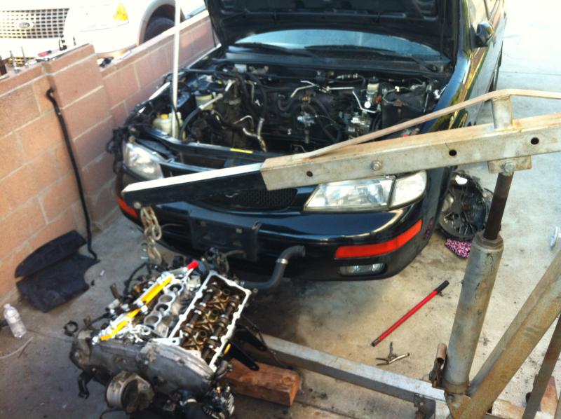

That's how my project started out...fix a rear valve cover leak,and a front left strut, which turned into EVERYTHING else!!! I too just cut that line, maybe I just ran out of patience, considering I cut it with a saws-all and a long blade! I was thinking the same thing about bypassing the UIM cooling line. But I didn't think of the EGR (I'm keeping mine) heat soak. Wish somebody, or myself would have taken a temp reading at idle with the line on, and with it bypassed. I'm a little sketchy on by passing it now. I plan on doing the 00VI install, and I read it was necessary to bypass that line anyways, right? Is that again, 00VI w/o an EGR or w/ an EGR (or does it matter)?!?
Just to show you my mess...
Attachment 2759
I was told not to bypass anything and they did it for a reason. So I took the trouble and reinstall it just how I took it off.
kroze is offline
Old 10-24-2012, 11:57 AM
OC95Max's Avatar
Join Date: Sep 2012
Location: Anaheim, CA
Posts: 36
Crap! Not what I wanted to hear.
