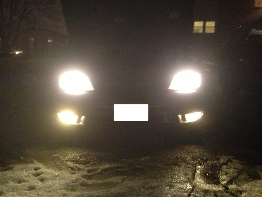

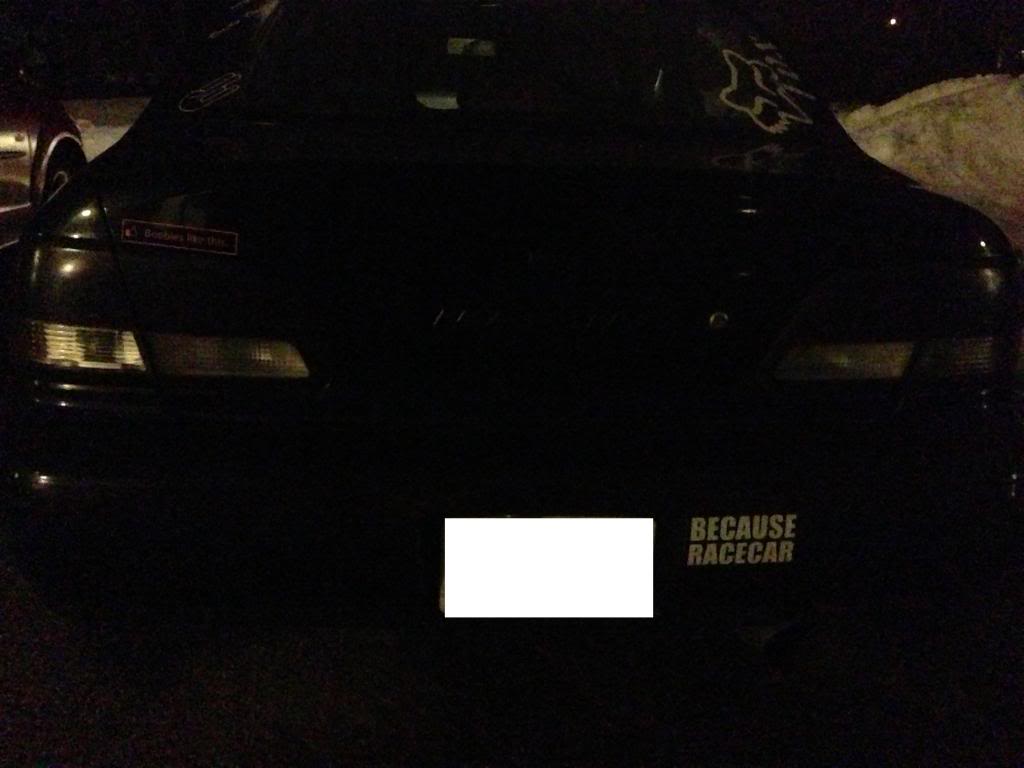

I've still got this issue where my headlights will turn on but the corner lights, parking lights and tail lights(not brake lights) won't turn on. Dash lights and illuminated door switch lights(windows and lock) are not illuminated.
Fogs still turn on with the switch.

Headlights and fogs.

No tail lights while headlights are switched on.

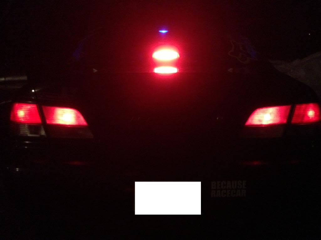

Brake lights.
Directionals and hazards work like normal.
