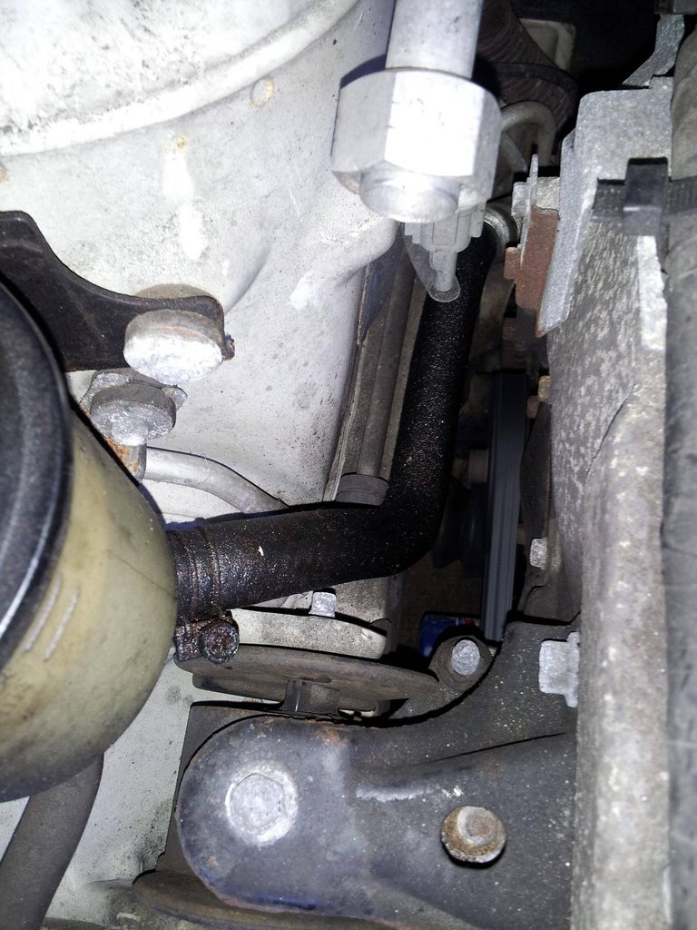

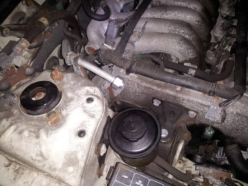

Power steering fluid is a little below max, and I know why. I have a leak at the return line, as well as the main line but the leak seems to be due to bad clamps. Do I switch the clamps or just clean the hose ends to clear any residue?

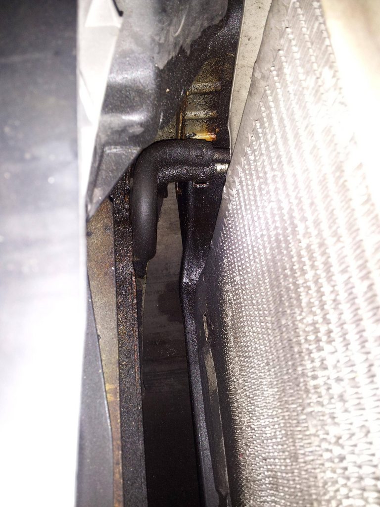

The A/C compressor line to the radiator is missing.. does it need to be welded to the radiator or do I just get one from a junk yard and plug&play? Also, is it okay to ride around like this?

2 - Power steering fluid is a little below max, and I know why. I have a leak at the return line, as well as the main line but the leak seems to be due to bad clamps. Do I switch the clamps or just clean the hose ends to clear any residue?

6 - The A/C compressor line to the radiator is missing.. does it need to be welded to the radiator or do I just get one from a junk yard and plug&play? Also, is it okay to ride around like this?

2 - Power steering fluid level below the max line isn't a problem. The leaks are. The power steering uses Dexron type auto trans fluid. You can try changing the hose clamps but I doubt that it will help. Unfortunately the Maxima hoses have to be replaced. AND - the ATF oil dripping on the lower control arm rots the bushings.

6 - The a/c lines screw into the condenser coil. It's not the radiator they attach to. But you can't just put a hose on and charge the a/c. Since it has been running with an open hose, the the inside of the lines and the compressor will have to be cleaned and evacuated so that there is not dirt or water in the system. If you get a line from the junkyard (which I don't recommend), make sure it comes off the same year car. But it is not dangerous to drive the car like it is.

When I replied originally, the photos didn't display. Now that I see them, I have to re-comment on the power steering hose leak. Those are all low pressure lines for the oil cooler. So new hose clamps will probably work. My original comments were in regards to the high pressure hoses that run along the firewall.
