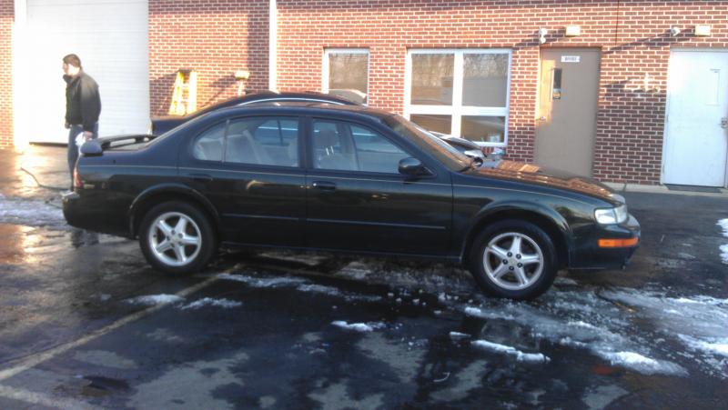

Wasup everyone, im Gene from PA. im new on here so heres my intro.
19, emt, 3rd car decided to get a maxima, ill save the bmw scene for later.
just got this maxi last week, 5spd, 200k, 1200$
im just gonna keep updating this thread whenever i put work into it.
so far just got a muffler delete, air intake, debadged trunk.
next im gonna do regular maint. brakes, oil. as far as visual goes, tryina get red/white tails, or if i find it anywhere, just the plastic white replacement pieces for rear turn signals. also attached some pics of previous 2 cars. thanks for looking!

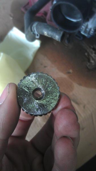

so last night i was about to launch the car at a light, clutch in, 1st gear, vroom vroom vroom, let go of the clutch... vroom vroom.. wtf? car rolls back. what ever gear i put it in, it does not move, it does not stall either, and if i put it in 5th and let go of the clutch speedo goes up to like 20 25 mph.. while the car is standing. goes in every gear fine, just doesnt drive or stall. anyways m boy told me its the clutch... thats what im hoping for that its only the clutch.. i looked around google but didnt find anything that car relate to me. my clutch was never slipping, i could put it in 4th gear going 20 miles an hour an d floor it and itll just b strugglin but not reving up for no reason. any help here? i need to make sure its the clutch before i go shopping... like when i popped the clutch last night, it didnt make no noice, no nothing, just smelled a little bit and didnt move.
thank you
thank you
Could be the slave cylinder or the clutch. Start small lol. Could have lost hydraulic pressure or something.

but for my main problem, i just remembered that when i was changing the driver side strut , i seen a little drip of oil coming down, and like when i took out the strut assembly, the axle like poped out... idk i put it back in but i think theres a possibility that it came out again and maybe thats why my car does not drive. even when the car is off, i can put it in any gear w.o a problem, but if i push the car it will roll.. so like maybe "wheels aint connected to the tranny" im about to go to work and on break gonna lift her up and see. if it is the axle.. ill b a little upset cause i already ordered a stage 3 clutch
okay so it was my axle. it actually wore off like a little bit. so if any on you guys see ur axle pop out, make sure to shove it back in, hear 2 clicks. i didnt put mine back in with enough force( no force at all) and this is what happened. my clutch was pretty bad too, so they replaced that also, stage 3.

anyways so i dropped it off, next day they call me and say its ready, that they found one of the 2 pieces that came off m axle that they couldnt find when they replaced the axle. he said "watch out, i couldnt get the other one as in i didnt find it but i drove the car and its fine. as i drive away from the shop same thing happens again, 1st, 2nd, 3rd, N and after that shifter wont go left. drove it back to the shop backwards, when i get there, shifter works fine engages all gears fine. so i go for another spin around the block, same thing happens, i pull over at a gravel parking lot, a little bumpy, as i come to almost a stop, it lets go and goes left just fine. i drive away, 1st 2nd and then it wouldnt come out of 2nd! i mean it came out of the gear itself, but the shifter wouldnt move, as if something is in the way.and once again as i hit some bumps it went back to operating normally. tomorrow they will take out the other axle, see if that piece can be reached in the tranny incase thats whats causing the problem. if not, tranny gonna come out and get take apart.
i do have bad engine mounts, it does move a little bit if u fk up on shifting or just jerk the car, so im thinking there is a piece of that axle stuck in the tranny and during certain conditions like movement and sht it gets in the way. linkage looked fine( well while it was on the lift everything was working fine anyways).
ill let you guys know whats up tomorrow. only thing is i really dont wanna spend alot for that tranny to get taken apart and car will only drive and look the same as before.
