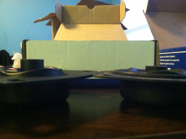

So I ordered these strut mounts because I saw so many recommendations for them. Well I went to install the mounts and even on my kyb shocks that have a longer stud I can only thread the nut about halfway on. Don't even think about using them on the Oem shocks.
When sat upside down next to each other the moog one is significantly taller. I'm baffled by this. Anyone else have any issues with installing them?

Maybe im doing something wrong but ive been lowering cars since i was 16(10 years ago) and never seen something like this. Any help is greatly appreciated as my car is sitting on stands at the moment.

Wrong part?

Interesting, the k90655 is listed for 00-08 Maxima.
What mount is the shorter one? Its not an OEM 4th gen mount.

I ordered two sets from eBay one set came with used parts and this set appears to be wrong. The other mount that I received was shorter but it was an Oem part. So it was just like the ones that came off the car.
This has went from a simple install to a complete headache. And it looks like my car will be sitting for a few weeks because I also stripped the threads off my new shock trying to install this mount. Stupid I admit but there's no changing that now. Hopefully I can get refunded and just go down to the parts store.

Wow apparently I ordered the wrong mounts? Which would mean the parts store gave me the wrong number....

Well mystery solved as well as my pride hurt. Correct part number is k9786 for future reference.
