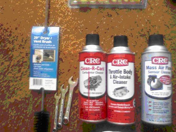

To the OP (Huma) - you should be able to find something called MAF cleaner, brand is CRC. Use that to spray your MAF with...WD40 is not recommended.
In this picture (which was in the thread you got linked) on the RIGHT is what you want to spray your MAF with. Be careful, as touching it with your fingers can break it, it's very sensitive.
