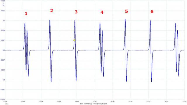

Crankshaft position sensor (REF):
AC signal, with a doublet every time the crankshaft completes a revolution. Cylinders hitting TDC are numbered.

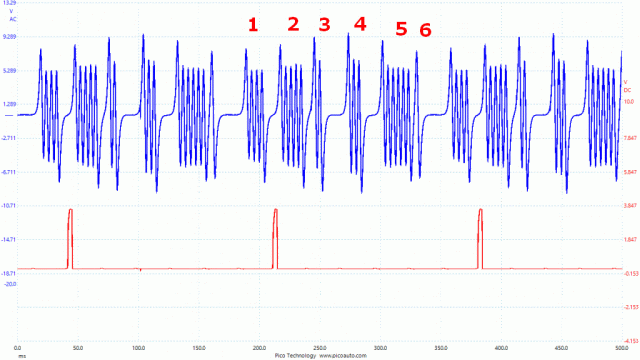

Camshaft position sensor:
AC signal, number of peaks indicates the cylinder at TDC. Signal pulse to coil #2 is shown in read. Cylinders are numbered.

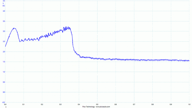

MAF sensor:
Snap throttle test. Voltage jumps up as air flows into the manifold, then decreases because the engine can't keep up, then comes back up until the throttle is finally released. Wiggles are the individual intake valves opening and closing. Voltage peaks around 3 V, the hot wire might be a little dirty.
