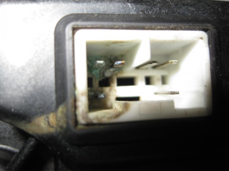

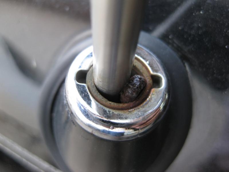

Problem solved. It was a short in the rear antenna wire. Water trickled down from the antenna pole to the plug and shorted out some wires.
Old Jul 27, 2013 | 01:10 PM
QueensMAX's Avatar
Joined: Apr 2013
Posts: 188
Someone put a screw in the antenna pole to keep it up leaving it susceptible to water (pic 1). Over time the water pooled in the plug on the antenna motor and shorted out a wire. (pic 2)
