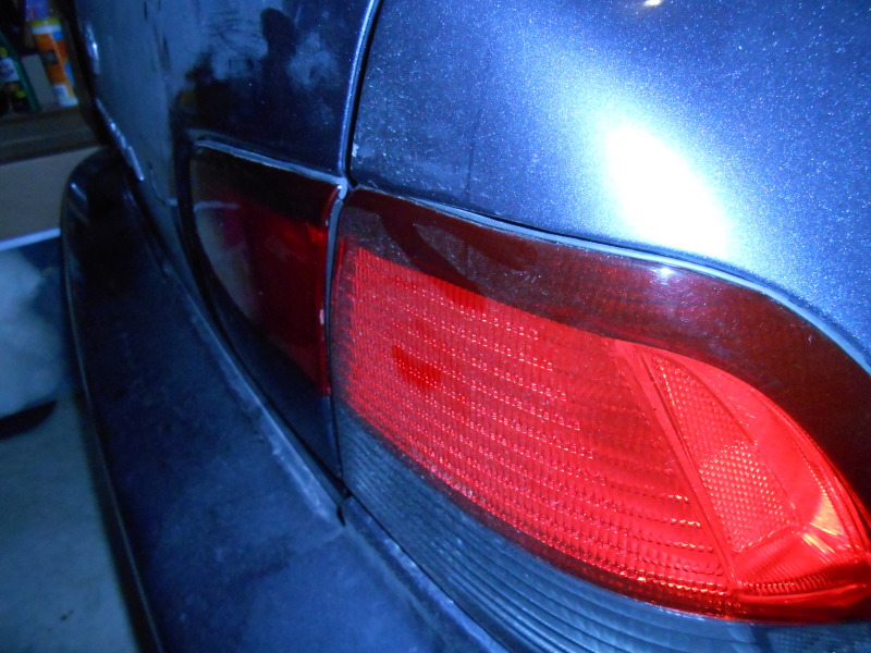

I ordered some new red\clears for my 97 4th gen and the 2 corner pieces fit perfectly with no problems but the 2 inner pieces don't aren't flush and its really bothering me. The left side isn't so bad as the right.

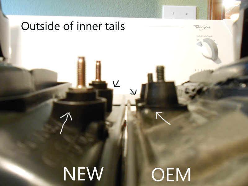

you've gotta get yourself a dremel and grind off about 1/4 inch of the circle the studs mount to. See this pic I took that shows the difference:

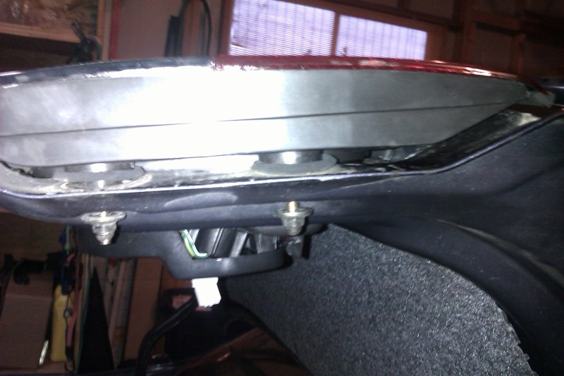

Bet they look like this, right?

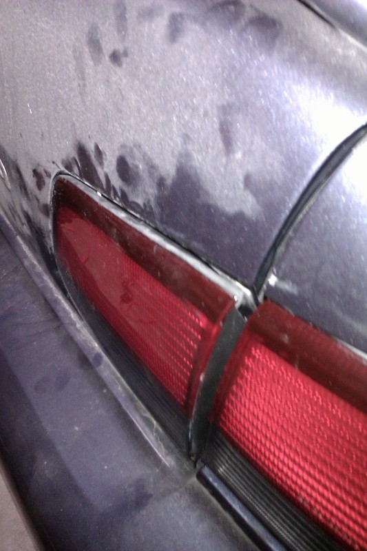

You can see where the lip touches the trunk lid...

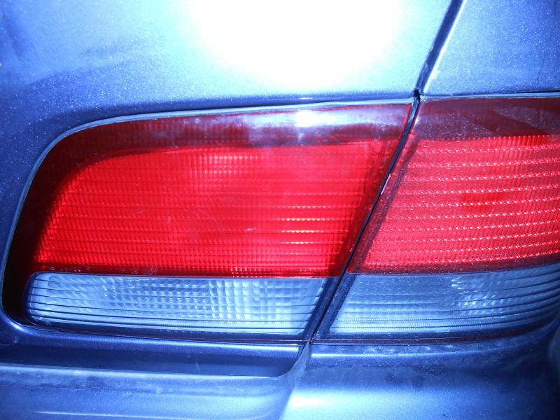

After dremel work:
ALSO: Get yourself some NON-capped nuts for those studs. The stud length is longer so the OEM capped nuts will NOT fit. They're the 8mm nut - M4 or 5 I believe. Take one to the hardware store and compare to be safe.
Nice and flush afterwards
