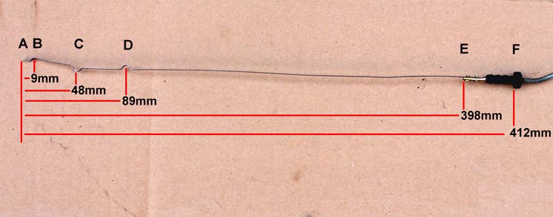

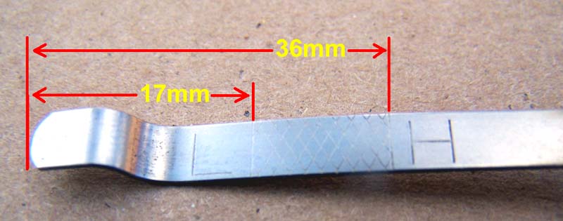

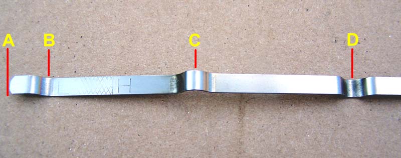

Hello everybody, I'm new to the forum, I searched before but found nothing on the subject.
I am Brazilian, I live in Florianópolis, SC
I bought a 1995 Nissan Maxima was stopped for some time, I'm putting him to run again, and the same does not have the dipstick.
I wonder if anyone knows the size of the original rod, and the distances of marking levels. Since I do not find this piece to buy in Brazil, I have to make one.
If someone who has the same model, and are willing to make this measurement, would be very grateful!!

Can you find a wrecked car in a salvage yard? The dipstick is the same for 1995 through 2002.
edit:
The dipstick is the same for the 1995 through 2001, not 2002. It is the 3.0 liter engine. the 3.5 is different.

It is approximately 3/16" wide, 15-5/16" at the high mark, and 15-3/4" at the low mark. Sorry, I do not have a metric ruler long enough. I trust your public schools are better than ours, and you will have no problem.

They are not the same between the VQ30 and the VQ35. The VQ35 dipstick's markings are a little further from the end of the dipstick than the VQ30.
