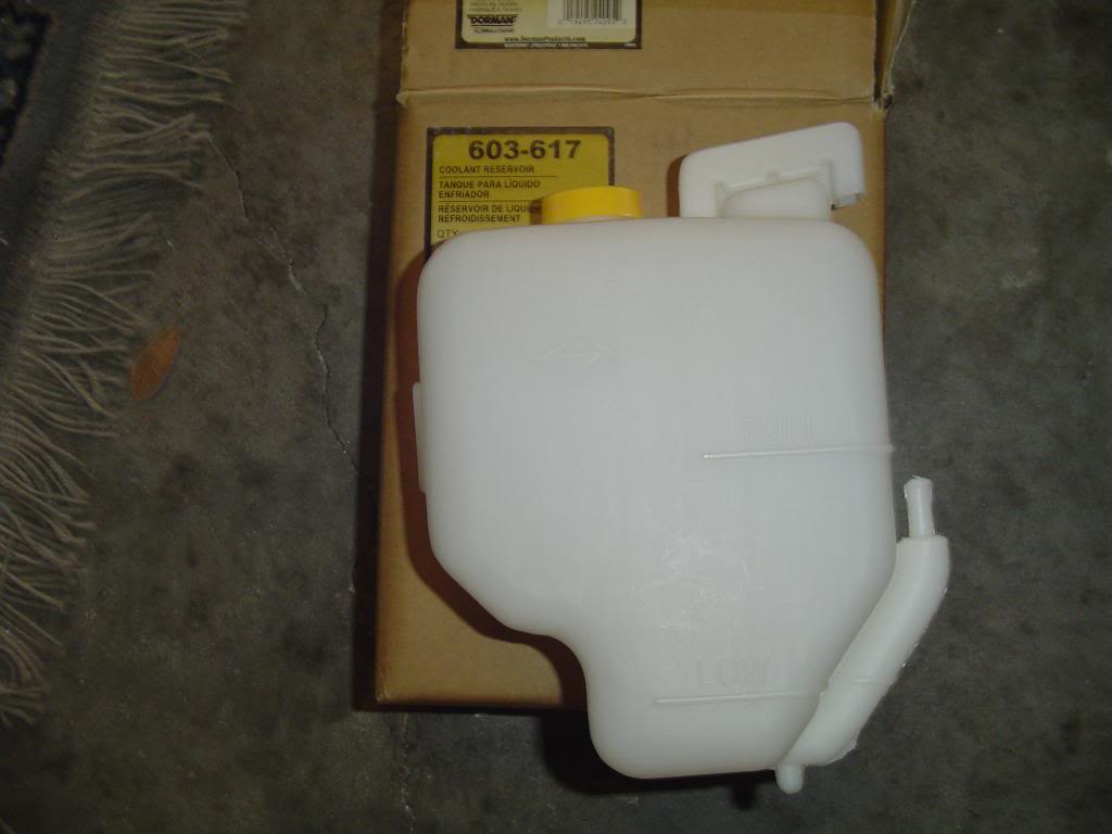

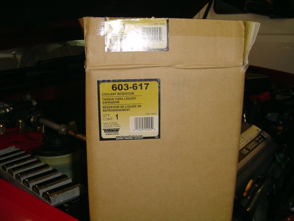

I now have a complaint about a Dorman part. This one is just wrong and cannot be installed. This is NOT an OE replacement part.
The Dorman tank has no mounting tabs. Based on the mold of the tank it appears that it must be snapped into some sort of bracket that, in the 4th Gen e-compartment, does not exist.
I've also shopped for the bracket that the tank appears to require with no luck.
Dorman P/N:
Dorman part:

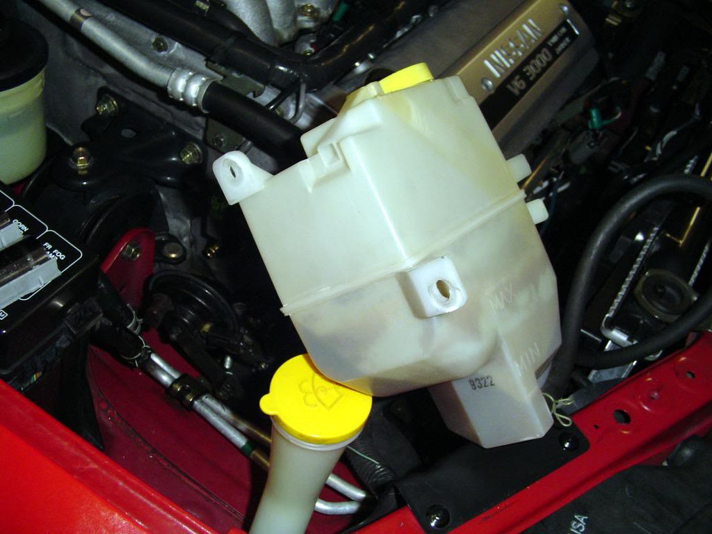

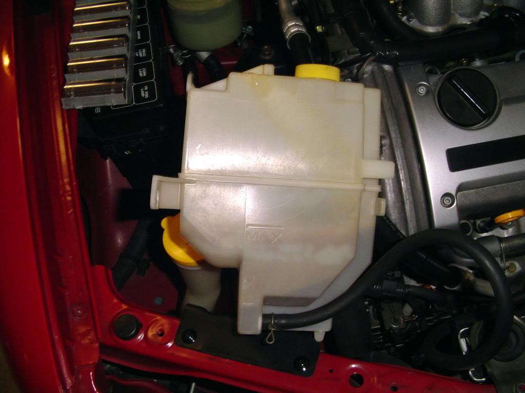

OE tank:
OE tank. Note the mounting tabs ... which are absent on the Dorman part:

I just got some exceedingly interesting information back from Rock Auto (that's where I bought the Dorman tank).
I actually did buy the wrong part. But not because I chose the wrong part.
Both Rock Auto folks and Dorman folks have been researching my issue for the last few days since I alleged that the part Dorman says is appropriate for a 4th Gen Maxima is, in fact, not and based on my photos appears to be true.
I sent the photos and my VIN to Rock Auto and they in turn sent that info to Dorman.
Turns out I have a 5th Gen reservoir in my 4th Gen. The appropriate Dorman replacement P/N for the 5th Gen is 603-505.
Not sure any other end-of-model-run 4th Gen owners might run into the same issue but I wanted pass this most interesting tidbit of info on.
BTW ... based on this craziness, Rock Auto is refunding my money and they are not requiring me to return the part.
