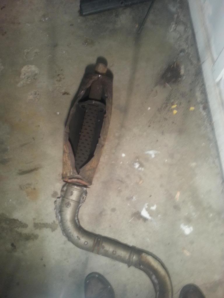

Nevermind, no pics of the muffler. Girlfriend put it on the curb yesterday for garbage pick up. Haha I didn't even know. I still have the resonator though. Pics in a second.
That's the resonator, if you could just imagine the muffler, it was exactly the same. The Y had completely been severed at the Y joint.
SORRY FOR THE WAIT EVERYONE!!! D:

That thing really opened up. Wow.

damn man, exhaust must of sounded real good. maintenance much??
Old Jan 15, 2014 | 11:58 PM
Wow. That must of been quit the explosion!

Looks like a wild & violent explosion took place under your car...

Wow, it is kind of hard to imagine that kind of explosion without the muffler being plugged up or something.
But whoaaaaa
