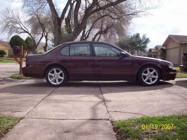

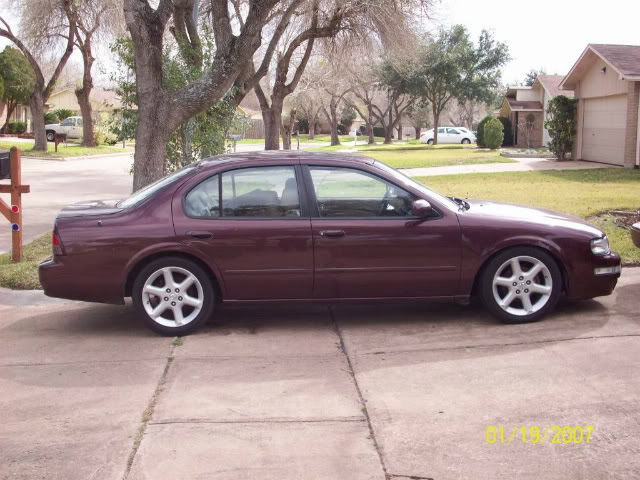

Yeah thanks correct 2.2" drop in front 1.8" rear. My Maxima had the same AGX for 10 years....So I know they were good for about 8 yrs. I've got a blown front strut and it still handles very good! Replacing all mine as we speak!This setup is too low for everyday use, you have to stay alert, Awesome look Though:
