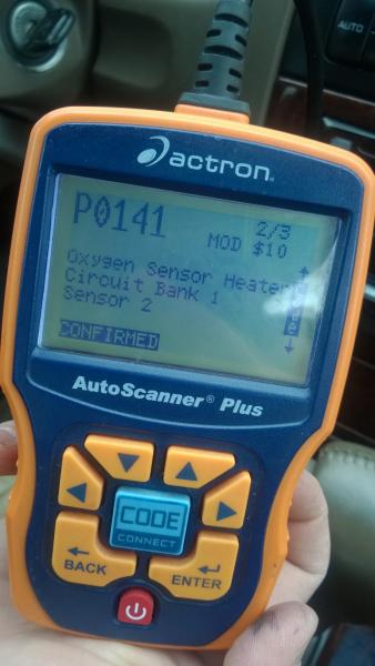

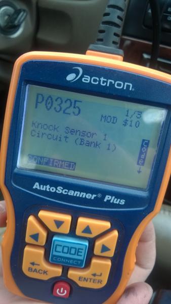

I bought the knock sensor for 130 in advance auto... now i need to know which o2 sensor to buy... I have the california emission 1999 nissan maxima

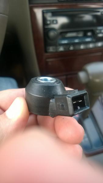

Here is the Knock Sensor I bought

Sadly the knock sensor was probably fine. O2 sensor codes trigger false ks codes. Ebay ks work great at $5-$10 too.

Waaay to much for a ks. They should take it back since it has not yet been installed, get your money and get one 90% cheaper..lol. O2 sensors are on ebay for around $28 each just get both.

Your code reader says its bank 1 sensor 2, but I'd double check that if I were you. Search for P0141 on this forum. Here's where I usually get O2 sensors http://www.oxygensensors.com/catalog...tion=Calif-ESV. I don't remember off hand which bank is pre and which is post cat, but you should be able to figure that out from your search. Someone else may be able to jump in with the answer.

P0141 bank 1 sensor 2 is the downstream sensor, after or in the main cat if I'm not mistaken. I am currently dealing with po141 and p0325, KC. I tested my KC and its dead. Also the downstream o2 only measures catylast efficiency, not A/F so I dot see how p0141 can trigger the KC code. I can see the upstream o2's causing a KC code because they control A/F ratios. I'm not saying that p0141 can't trigger a KC code, I'm just having a hard time wrapping my head around it.

Not on California spec...Which op has.
On his car, bank one sensor 2 is after the rear precat. Rear being firewall side

Your knock sensor probably works fine. Replace the oxy sensor and then the ks sensor will probably go away.

Oh yeah its a Cali spec car. Which has more o2's. Sorry. So does that sensor work the A/F ratios or does or simply measure pre-cat efficiency.

You can drive your car with a bad knock sensor forever. No engine damage will occur. Instead, your engine computer will dial back the car's power by about 10% because the ECU defaults to an fuel program assuming 87 octane even if you put in 93 octane.
I am going to go against the grain here, and your computer.....replace just 1 O2 sensor, the primary one in the exhaust manifold. You can see it directly when you open the hood....its like right there.
I did that on my buddy's 99 I30 (same 99 cali emissions VQ engine as yours) and his car has been happy ever since. A lot more pep returned to his car and his O2 code (which was NOT the primary) went away.
Reason being is that O2 sensors get tired. Alll your O2s may be tired, but the critical ones are the primary. The computer uses those to adjust air/fuel mixture, and therefore power.
All the other O2 sensors just check that the cats (pre and main) are working properly.
